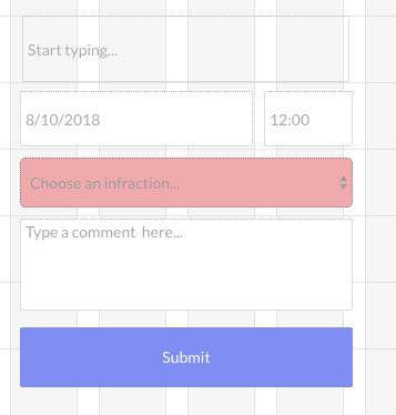

  3. I created a group with 4 input forms. This is my page 2.
06%20PM
Every teacher will use that group to submit a new entry into a third table (DH’s):
02%20PM

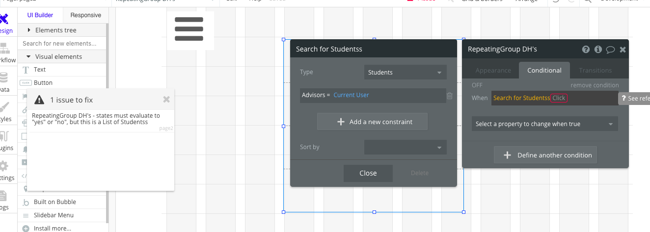

Now, and this is what I haven’t found a way to do, I want every user to be able to visualize (I’m using a repeating group for this on page 3): DH’s of students (only students which user is also an advisor).
I don’t know if I have a design problem with my tables or if the problem is the way I’m designing the repeating group on page 3.

That was a beautiful conundrum. I loved solving it. Thank you.
There may well be easier ways to go about it with a different database structure, but if you want to avoid duplication and stay with the database setup you have then this is how to get what you want.
  1. Make your RG of type DHs
  2. For data source Do a Search for DHs … now comes the nice bit :slight_smile:
  3. Set a condition Student is in Do a Search for Students
  4. Set a condition on that search for Advisor = Current User
Let me know how you get on. I built a little test version if you need access just ask.
This is where I get lost.
If I created a condition (When) what should I do in (select a property to change when true)?
Here you can see my application:
https://bubble.io/page?type=page&name=page2&id=dheasy0&tab=tabs-1
Would you be able to show me your test version, please?
Thank you!
I think I did it!
Great - it was a CONSTRAINT not a CONDITIONAL
