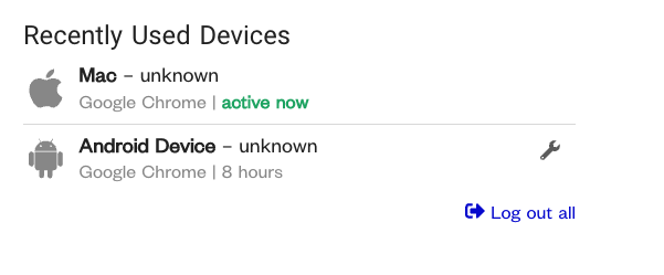

Hello Bubble community,
I am trying to create something like this
I am able to get device info from this plugin
How can i logout of all devices ?
@mikeloc @adamhholmes @sam.morgan @Jici
Any help please ![]()
I may be wrong, but working from Browser have some limitation around that. You will need to:
A) Create a DB thing with Device info and a status and date for last used.
B) Set cookie on the device = to created DB Thing
C) On each page probably, Get the session ID (cookie) and do a search for in DB. Check status. If “disconnected” log the user out and send them to login page. If not disconnected, update last used.
I could be off base here, but isn’t that what this action is supposed to do?
I was thinking to log out on a specific device. But if this is for all device, @mikeloc is right
