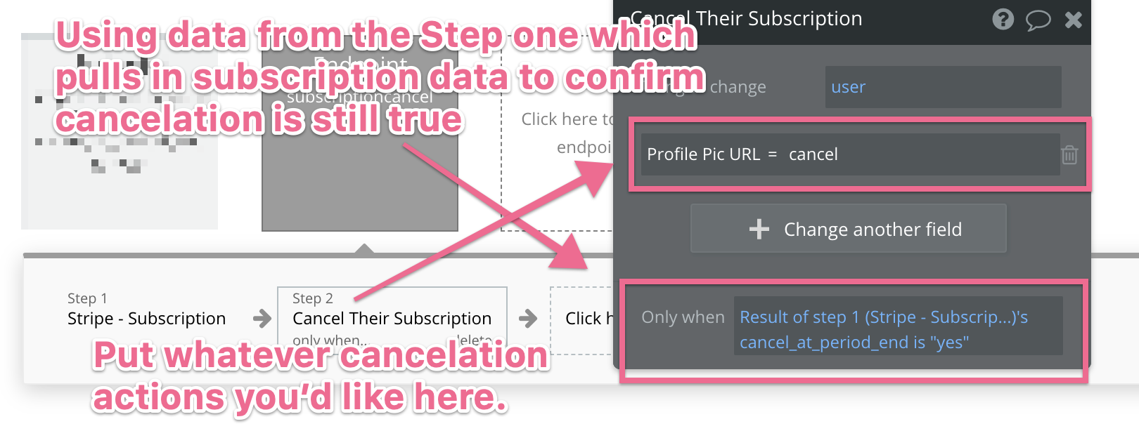

We’re going to have this one cancel the subscription in-app and update the user, however, we’re going to add a first step which verifies the subscription should still be canceled;
We’ll need to create an API via the API connector to do this first;
(Stripe Docs: Retrieve a subscription | Stripe API Reference)
Also, for this API you’re going to use an HTTP Basic Auth;
[Password remains empty per Stripe auth docs]
Now that we have this API we’ll create an API endpoint which cancels the user in-app;
An additional step, for this you’ll have to change “cancel_at” to date in the “modify” tab;
15%20PM
Now that Bubble will recognize “cancel_at” as a date we’re going to use this to schedule the cancelation API;
First, add the “Schedule an API workflow” available under “Custom Events” then schedule your user cancelation workflow which updates the user in your app;
In this, I am using their Stripe User ID to find the customer;
