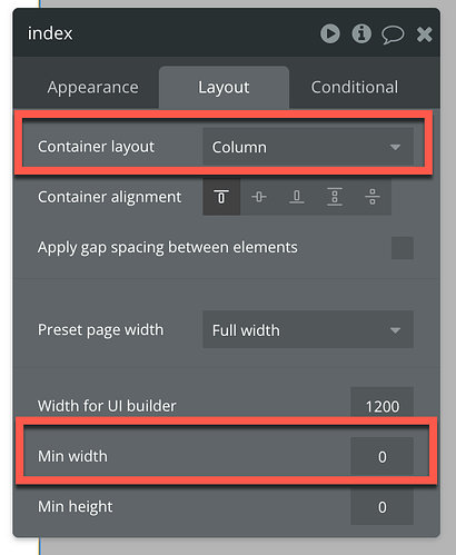

What are your responsive settings at the page level?
These options?
Props to @bcart0v for finding the n00b error I was making. Wish they’d include a tooltip when those views are disabled for this reason! Thanks for the quick and easy solve.
