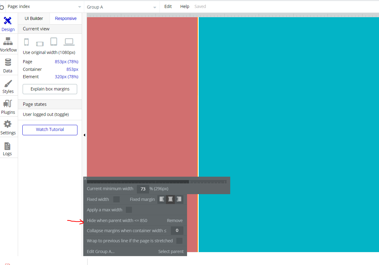

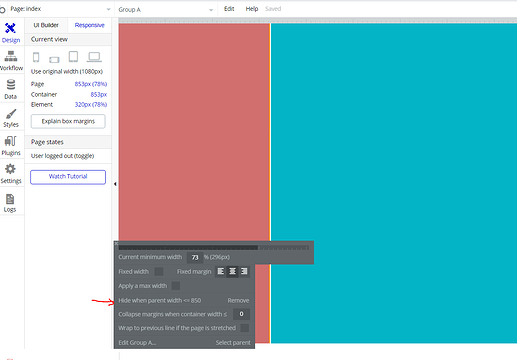

You can achieve that by using “add hiding rules” on responsive view. You can set minimum page width before the element go hidden, it will give additional space for other element that still visible to fill. Please see screenshoot below
Set the hiding rule
After page width pass the minimum limit, the element will be hidden and give more space to other visible element.

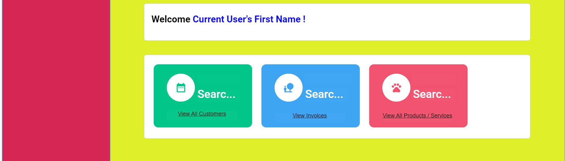

Yeah thats what I have setup. The side menu group is setup to 230px fixed width, the content group set to 970px width (non-fixed, and min width of 99%). I have the page width set to full width.
I have the hiding rule set to 940px. When I resize, the hiding rule kicks in and the side menu group disappears. All good so far.

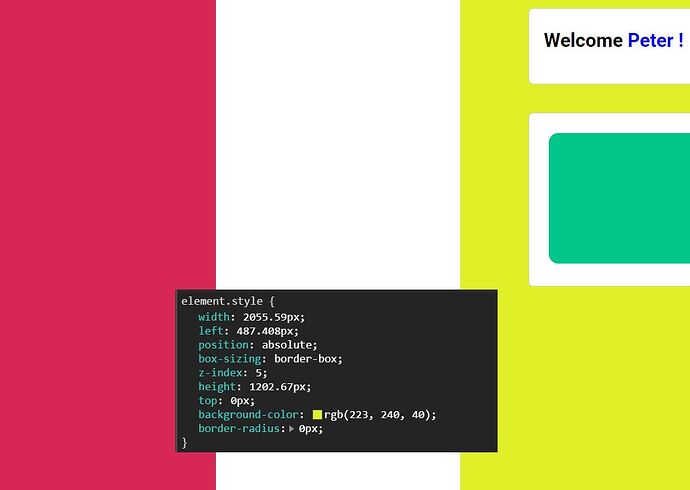

When I go back to desktop view, there is a large gap between the side menu group and the content group. I’m guessing that this is because my monitor is 2160 wide, and the max width of the content group is only 970px. I’ve tried to set the content group to 2200px wide and try it out, but then when the side menu group is displayed, the content group goes under it.
not sure how to fix this in bubble. I’ve looked at the inspector in chrome and can see that the content group element has a fixed pixel width and a fixed left position set. if I change them to be width: 100%, and left: 230px, it all looks fine.
