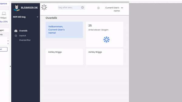

I have a major issue that stops me from proceeding. I am building a collapsing menu on the left side of the page. Then triggered by a button, it should collapse and expand the rest of the content on the page.
The menu itself is a floating group anchored to top and left. The top bar is also a floating group anchored to top and left, but is less important.
See GIF on preferred behavior:
ezgif.com-gif-maker (1)
See gif on current behavior ( just triggered by a downscaling of the page):
ezgif.com-gif-maker
Ive tried everything, switching type on the floating group, putting an empty group behind the blue menu group, using conditionals to hide the elements, using responsive designer to create hiding rules, nothing works.

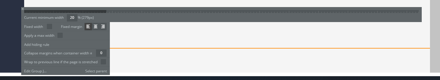

Have you added a hiding rule to the empty group beneath the side bar?
Yes. But the issues is that i want the users to be able to hide it manually from a full screen view, and not only when the page is a certain width. I cant get it to work using a workflow either.
Im assuming you are talking about this setting here right?
Unfortunately i am not seeing any changes. What would you suggest to set it to?
