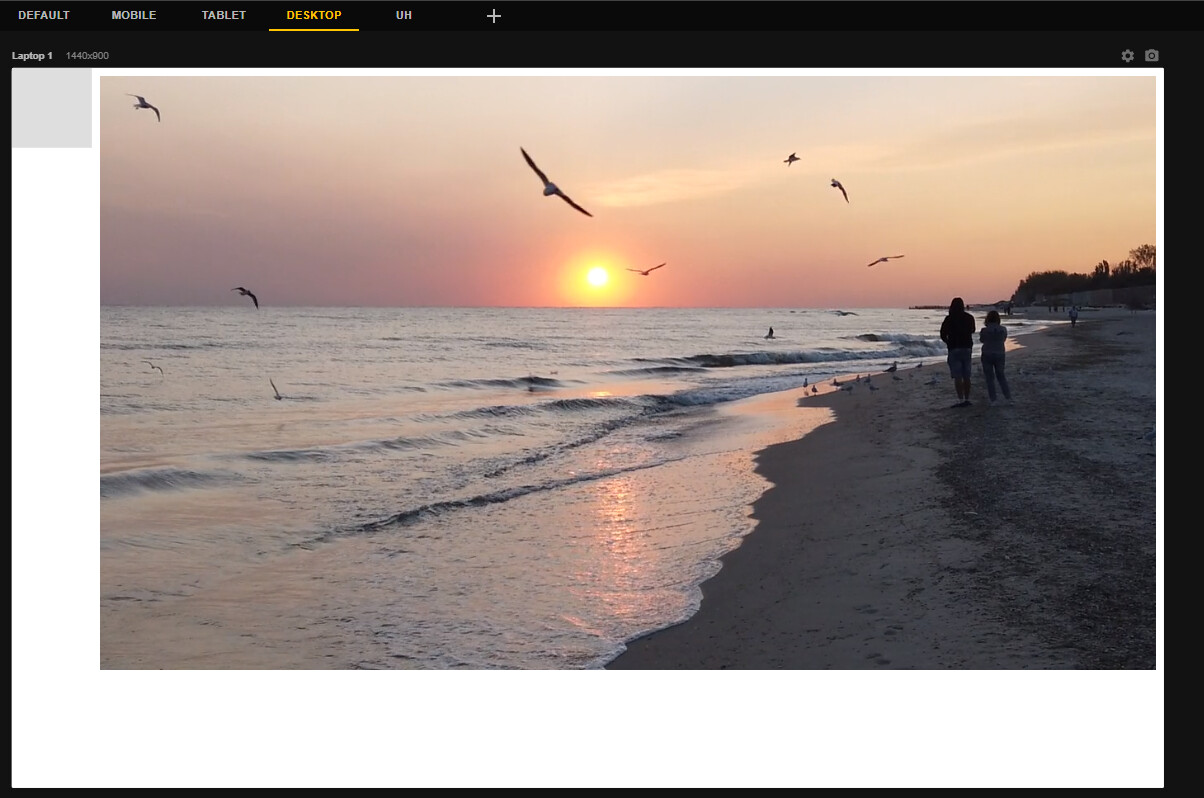

Here’s how I get a responsive YouTube hero video without CSS or putting in conditionals based on screen width.
Summary: your first element in the align-to-parent group is a dummy image. Images allow you to keep the aspect ratio. So make the image the same aspect ratio as your video. You could even use your poster / placeholder image that you created for while the video is loading. You make the parent group hug that responsive image, and then anything like the video fills the group.
The parent align-to-parent group’s settings are:
fixed-width = no
min = 0, max = inf
fit width to content = no
fixed height = no
min h = 0, max h = inf
fit height to content = yes
dummy image settings
centred
min w = 0, max w = inf
keep aspect ratio = y
Aspect ration w x h = same as your video
Video settings:
I use an HRML element - there are plenty of examples out there. ChatGPT wrote mine for me.
Alignment = centred
fixed width = no
min w = 100% max w = inf
Fit width to content = doesn’t matter because you set the width to 100%, see above
Fixed height = no
Min h = doesn’t matter, max h = inf
Fit height to content = no
Then on top of the video, or further down the element tree if you like, you can add your shading group, and text, into the parent group.
