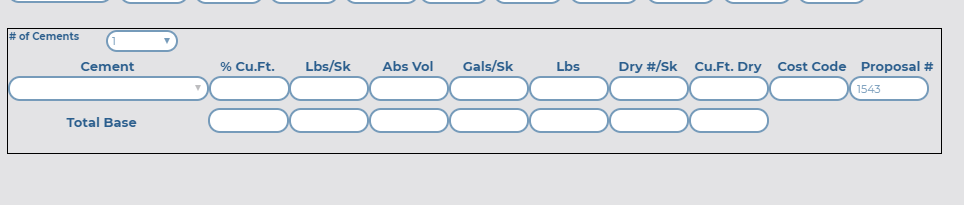

Is there a way to make a RG dynamic in such a way that when I change the value of a input a new row would appear?

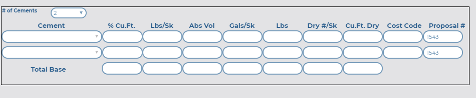

When # of Cement changes a value the RG would add add a visible row.
I.E. If # of Cement value was 10 the RG would show 10 Rows.
I am currently doing it with separate groups but i have a lot of Expressions to add and a RG would simplify it.

Just giving an update so if anyone has the same issue. With the help of @curt.rice the solution was to use a group within the RG and format a conditional that was
When>Input X’ value equal to or greater than Current cell’s index.
