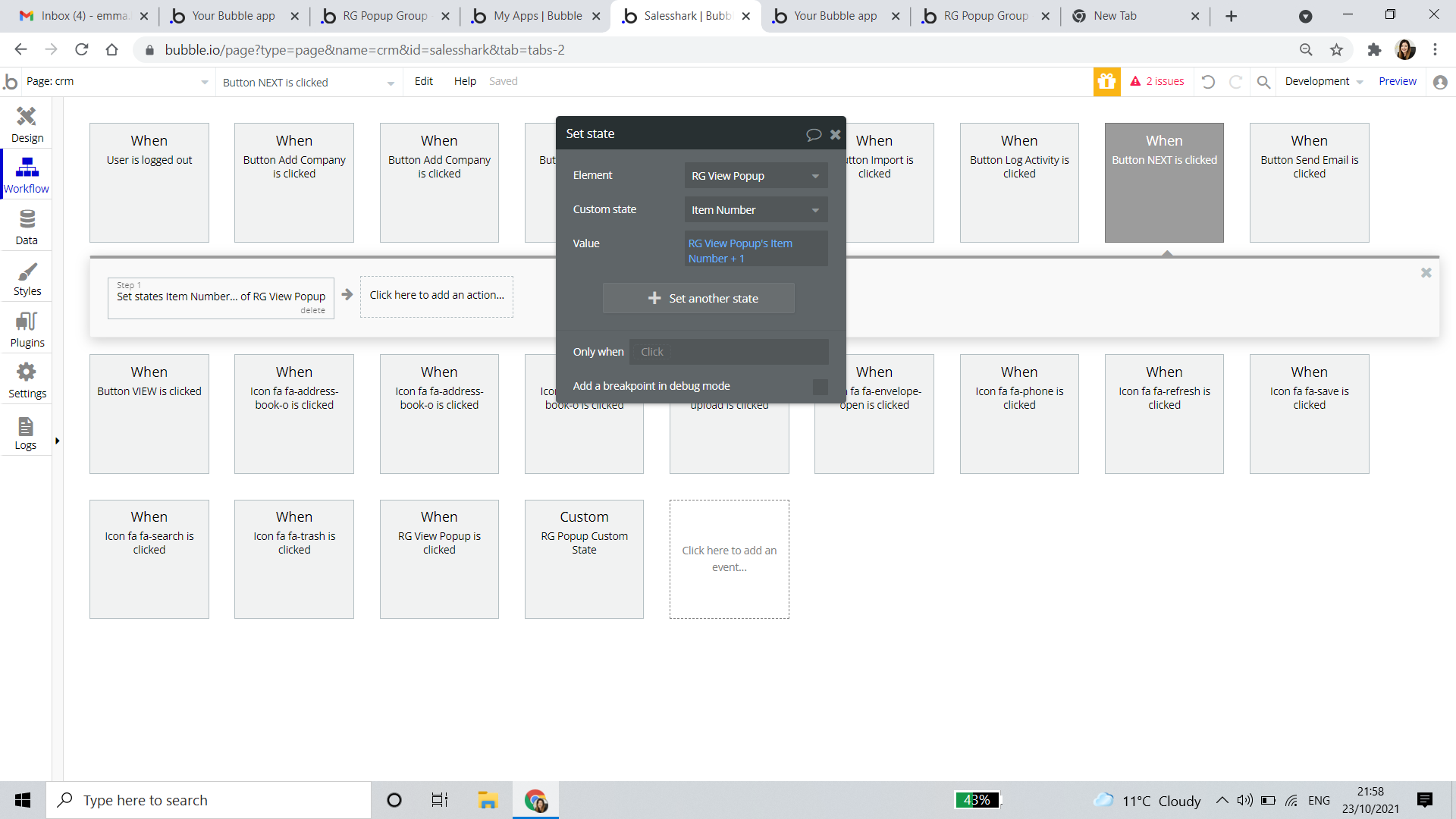

Thanks for that, I am stuck on the last bit… When I start a workflow for the button NEXT - It doesn’t give that option for current value + 1? Please see pic below of this workflow;
You need to refer to it directly via the element and state name…
So in your case, for the custom state value in the workflow set it to: Rg View Popup's Item Number + 1
