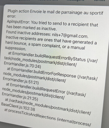

Hello @vini_brito I had this error message :
do you know what conditionnal to put for not having this popup ? thanks
You might want to use Postmark’s API to check if the recipient is unsubscribed or has previously bounced
okay got it thanks @johnny !! always there to help !
