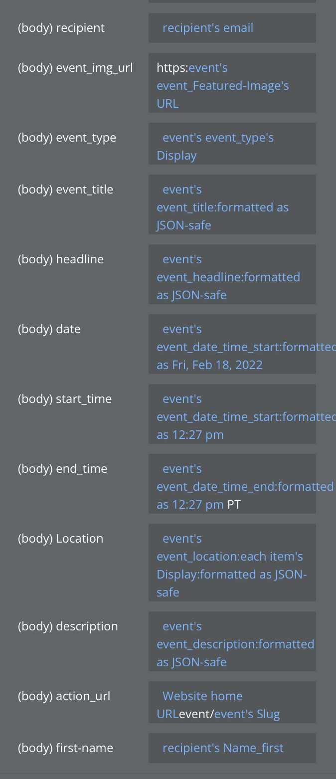

Hello Johnny, thank you for your help.
In simplest terms, the email is not sending. I’ve included images of one example that’s not sending. I’ve tried several different suggested fixes without success. Wanting to know what’s the proper way to have this setup.
The more complex issue is I’ve been trying different solutions based on different people’s advice and while it seems to be workin in some cases there does not seem to be a universal way to get these emails to work. I feel like I’m constantly chasing down issues individually instead of knowing the one right way to set this up so it consistently works.

I would like to think using Format for JSON or \"or whatever the proper way to do it would be the same? So maybe if I can figure out the proper way to do it for one I can then set them all up the correct way.
My biggest concern right now is the event email notifications, and I’ve included al the setups in the images above in this thread. Please let me know if there is anything else you need to see.

If you look at the first post in this thread I think most of that is there. I honestly keep changing it to test different things, since as I mentioned I keep getting different advice, so at this point I’m not sure what to do. All I know is it’s not working.

In the Event Notification I’m having issue with you can see all the formatting in the first post in this thread. This is the one I’m getting the below error.
Workflow error - The service Postmark - notifications - Event Notification just returned an error (HTTP 422). Please consult their documentation to ensure your call is setup properly. Raw error: {“ErrorCode”:402,“Message”:“Received invalid JSON input.”}
Here is an image of a more complext JSON formatting, but it seems to be sending, and now I’m thining it’s issue of not sending to everyone is because of timing out. I’m hoping the Recursive will fix that. If it does, I’m just having an issue with my Event emails, which might be helped with Recursive, but I need a fix for the JSON code issues.
