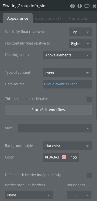

I have a page that is set to not be fixed width because it needs to be responsively designed.
I want a floating group that stays aligned as the page is expanded and shrunk.
The problem is that the only hacks spoken about on the forum make it so that the floating group will block content and make the parts of the page it overlaps inaccessible, which obviously is not okay.
floating group problem
The setup in the editor is as such
And the responsive settings needed to keep the content group aligned where it should be
I am hoping there is a way to make it so that the floating group doesn’t need to be hacked into performing an alignment, however bubble has not addressed this issue as of yet and there is still no alignment of floating groups available in the responsive editor.
So, is there a way to get the floating group to not expand to the left and blocking content on the page?

My current application has the main content held in a group that is set to not exceed 100% of it’s width. The page is set to expand, but the main content is not, so my previous hack doesn’t work.
Screen Shot 2019-12-18 at 11.05.41 PM Screen Shot 2019-12-18 at 11.05.20 PM
Check out this plugin. https://bubble.io/plugin/better-floater-1519462062405x558542008850841600
It will allow you to turn a regular group into a floating group. So the fake floating group will be affected by the responsiveness of other groups.
