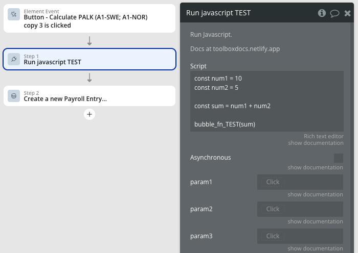

Workflow step1:

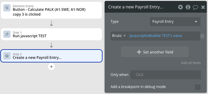

Workflow step2:

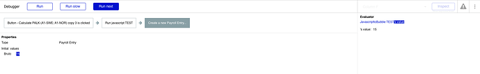

Debugger showing a successful “Create a new thing” with the right value. Yet DB ends up empty.

I suspect the thing is being created before the calculation result is ready.
Debugger can be showing the thing being created with the provided value but it isn’t always true…
Try placing a long pause between or taking the Run Javascript... action to a Custom Event to rule this in/out.
Tried adding a pause, it did not make a difference
Use an event triggered by the JavaScript to bubble element.
Thanks, it worked!
