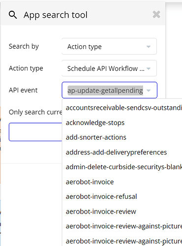

Painstakingly going through every workflow 1 by 1 to see fi we schedule it on a list, and if we do can we run it without interval. I wish there was an easier way to search… This is going to take hours.
You’re absolutely right. You will be one of many to have to do this over the coming weeks
