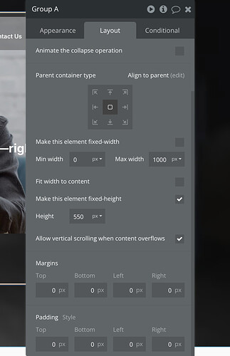

How have you currently defined the height of your group?
here it is
my website
As per my understanding and your current config, it should be allowing you to scroll vertically.
Can you confirm that elements not shown in the card/Group A are indeed not hidden and with non-zero height?

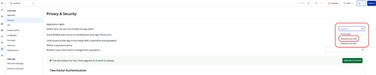

im still quite new to bubble, how do I do this?

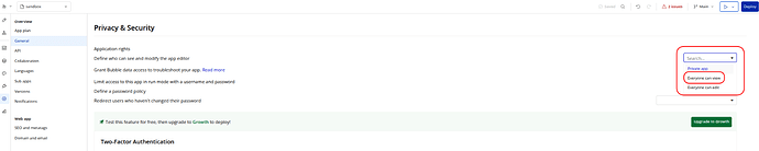

Just set this value to Everyone can view.
You can pass me the link of your editor, i.e. https://bubble.io/page?id=<appID>&tab=Design&name=index via DM. Just have in mind that anyone could see your editor, as long as they have the link, while your app with this config instead of Private app.
You can alernatively add me as collaborator with view permissions, but you’ll need to be in a Growth plan for that,

You need to set Group A to a Container layout column. You currently have it to Allign to parent, so all elements are on top of each other. That’s why the vertical scroll does not appear and you are only able to see the element on top.
