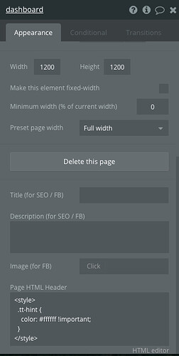

You can control this yourself by putting a bit of code into the head of the page.
First of all bring up the element controls of the page itself and then enter in the following code into Page HTML Header:
<style>
.tt-hint {
color: #ffffff !important;
</style>
Thank you that worked!!!
However I wish it could be in the Style for each independent search box. I have several. One in the header for search needs to have black background. One in the page are geographical and need white background.
To make it work in the header I had to put in the Setting SEO & Metatags /hearder
Many thanks again…
