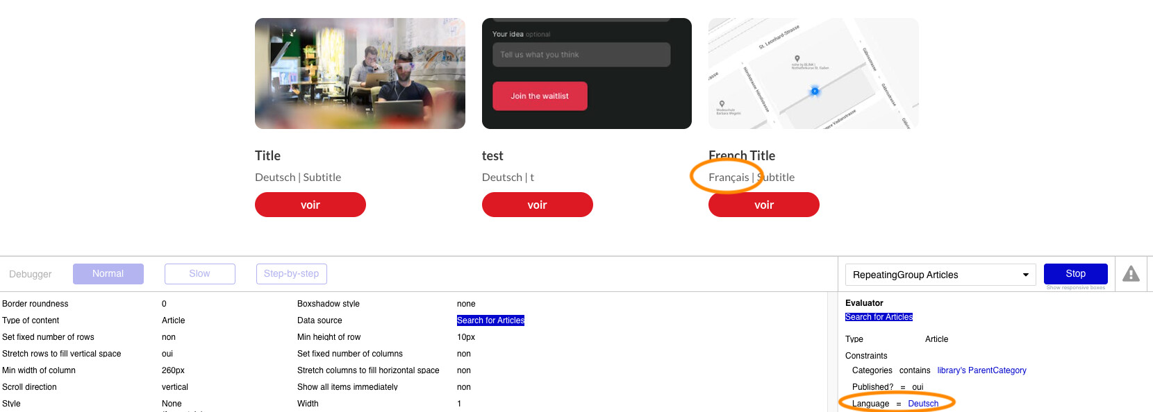

For testing purposes I am now displaying the language of every article in the subtitle. As this screenshot in debugging mode shows, the search constraint on the Repeating Group is “Language=German” but still it is displaying also content with “Language=Français”.
I am at the end of my ideas.
(with a condition “when Language is not … then the current cell is not visible” the other language content IS actually hidden, but instead of the hidden content the empty space remains, so this is not a way to go either🙈)

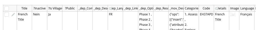

yes @boston85719 the “French Title” article has set Language=Français as displayed also in the list, and written in the database
