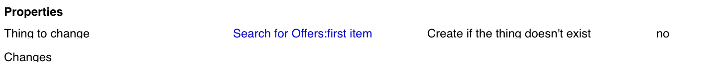

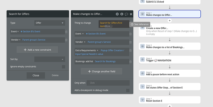

I have a weird issue where i have a “Make changes to a thing”, which is a “do search for:first item”.
I want to th debugger step by step ensuring my database is empty of this type up to the point this make changes runs. The moment the step runs, bubble creates that thing. However it seems that this option is off.
Is this expected behaviour?
UPDATE: It seems there is no way I can prevent bubble from creating this thing, any search for that thing, creates it, it never returns empty.
I was hoping to return null and then use the not empty for the next step to create that thing, so i don’t have to do another “search for”, seems like a wasteful way to do this.

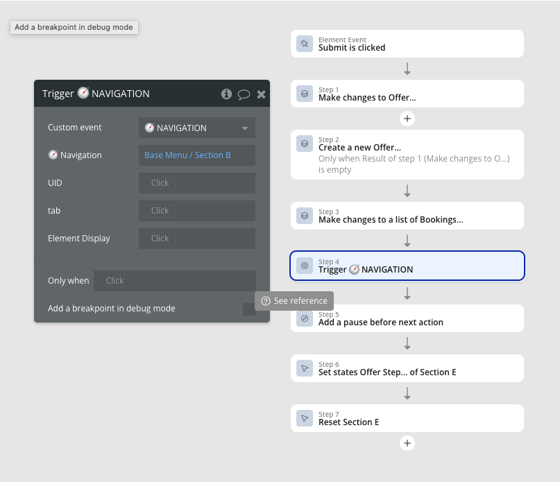

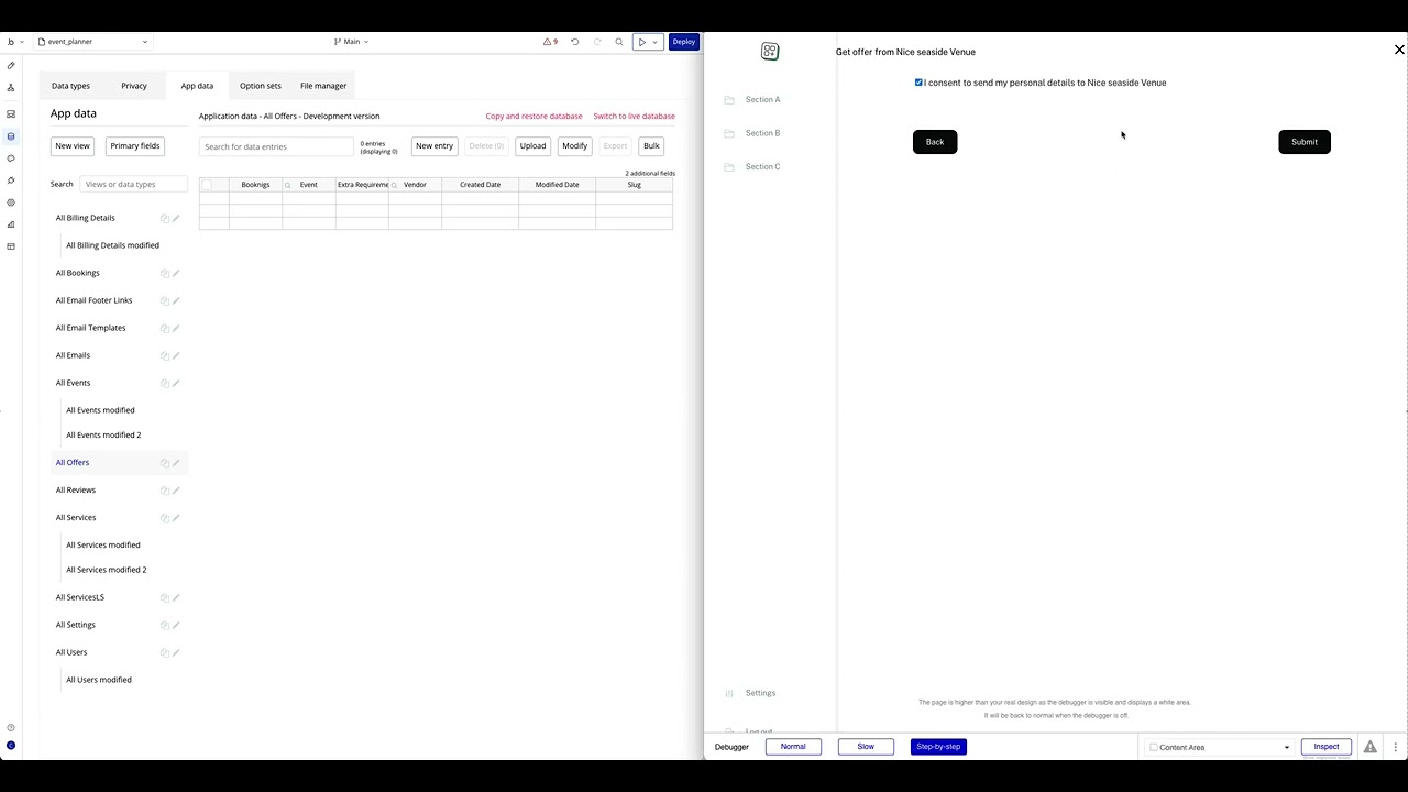

While doing a side by side for the video, I noticed that the entry is created before it even reaches the modify clause! I even deleted the “Only when” clause and it still creates the thing fully populated before the debugger reaches on this step (see photo attached).
I don’t have any relevant backend workflows, only for totally other things for sending emails, delete users, and retrieve dates. Nothing that works on the bookings or offers part of the database.
I checked all the elements above and bellow “Submit”, I don’t have any other workflows that could trigger together (even if they were, they should show on debug mode).
I tested also without totally empty database, but this is not the issue either.

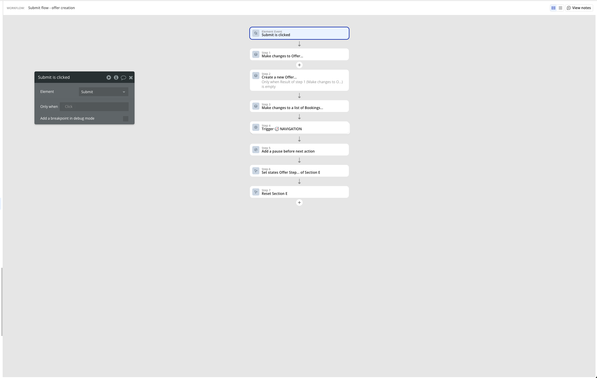

Yes of course, here you go:
Submit is clicked
Make Changes to Offer…
Create new Offer…

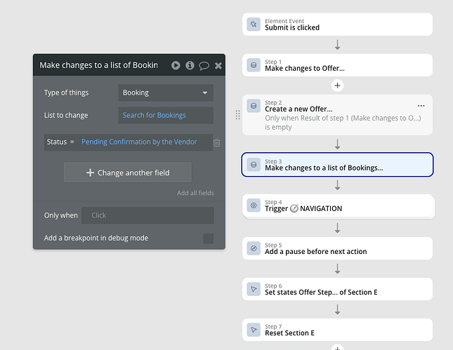

Make changes to a list of Bookings
Trigger custom event (Navigation)
Pause for 1000ms
Set state to 1 (this is because i have 3 screens/steps, so i am reseting it to 1st screen basically)
Reset Data
The logic of the beginning of your workflow isn’t right. Creating an offer should come first, and there should be a condition it. The next step should also have a condition on it, but it shouldn’t depend on step 1. You should have a condition such as “if offer exists is no” on step 1 and “if offer exists is yes” on step 2.
The condition on your ‘Create a thing’ WF is ‘when result of step 1 is empty’.
Meaning when no item is found to modify the thing will be created.
So it’s doing exactly what you’ve set it up to do…
Is that not your intention?
(btw, the debugger isn’t helpful for seeing when WF steps run.)

Thank you everyone for your answers, turns out @adamhholmes is right.
If I delete the create workflow, this does not happen. I naively assumed that debugger stops the workflows and executes them step by step, which obviously as seen here is not the case.
