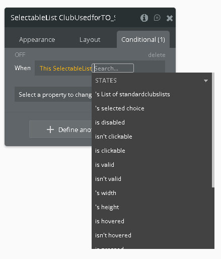

Is it possible to show a wait icon while a selectable list loads and hide it when it is loaded?
I do not see a selectable list property or action that tells me at run time that it is done loading.
My app is loading about 15-20 things only.
It can take a few seconds to load a selectable list and it looks like the app is hung up while it loads.
Thanks,
Guy

Hello,
I created a simple way to display a loading message for a SelectableList in Bubble.
When the SelectableList is loading, it isn’t visible on the screen, so its height is 0.
By default, I show a group with a message “Currently loading” and a spinner.
Once the SelectableList is loaded, its height becomes greater than 0, so I hide the “Currently loading” group. At that point, the SelectableList appears.
One warning though: my SelectableList always loads data, so I’m sure its height will eventually be greater than 0. Otherwise, if it stays empty, the “Currently loading” group would remain visible, which would be a bad UX.
Note: I used a threshold of height > 20 just to keep a margin and ensure the visibility toggle works correctly, even if there’s padding inside the SelectableList.

I implemented the solution and the "Loading… " text does not dissapear on height >= 20.
It’s working with bubbleGo and on live on iOS and Android. Can you send some screenshot maybe ? Because I have implemented this on different part of my app and it works everywhere
Bonjour,
Here’s a screen capture from my mobile editor:
This is the workflow when I click on Pick from standard list button:
I captured a video of what is happening.
See: https://youtube.com/shorts/fUZikqzMIu0?feature=share
Merci
Guy
Could it be because I am using a Shortlist and not a SelectableLIst?
I just replaced the shortlist with a selectable list and it still does not work.
Try to move your “Icon loading_standard…” inside the “Group Standard Club Option List”. This is where I guess is you shorlist list, right ?
On the icon editor check ‘the element is visible on view load’.
Finally on your workflow remove the step 1.
Tell me if it’s working.
Thanks.
It is working. I guess it is a question of visibilty?
I don’t understand why the other solution was not working.
Thanks,
Guy
