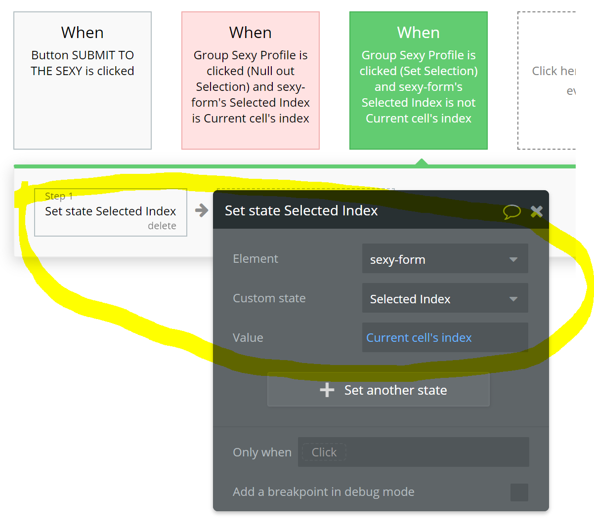

This is great @keith. Very simple solution and works perfectly. What would I do to de-select the group when I click it again?

Hey Max. Just null out the selected index value (if the clicked group’s index is the same as selected index). In Bubble we do this by setting its value to empty (you literally leave the field empty as shown below):
You’ll note that if you think about the logic of this, you’ll of course need two workflows – one to set the state and one null the state out when we need to. In Bubble this is like so - here’s what we want to do when Selected Index and Cell’s Index are different (this is what you’re already doing, basically):
And this is what we want to do when Selected Index and Cell’s Index are the same:
