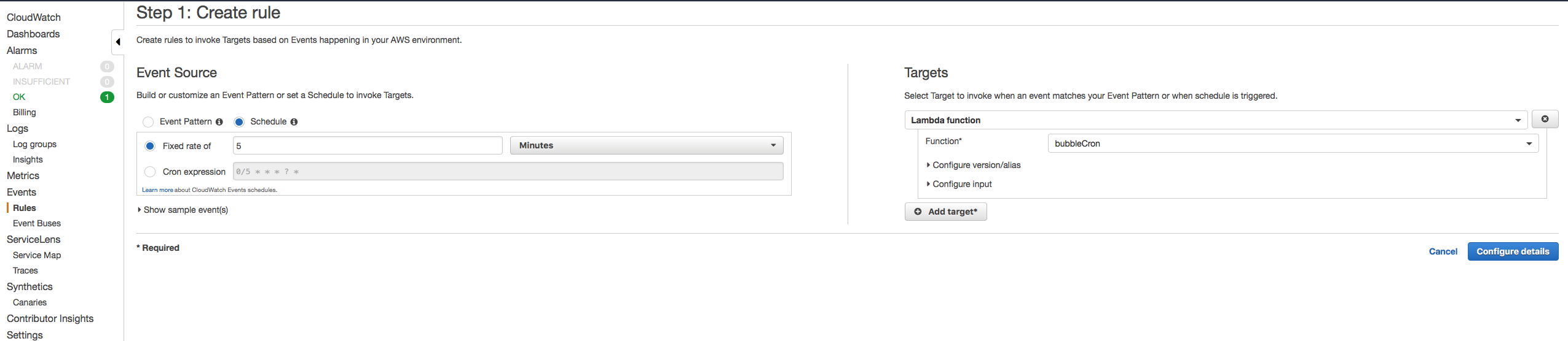

When that’s done the cron job should be set up. Head over to Cloudwatch. Choose rules, create rule. Under Event Source choose Schedule and “Fixed rate of” then 5 minutes. On the left pane you choose your target which is the Lambda we just created, so find bubbleCron under function, hit configure, give it a name and click “Create rule”.
Congrats, this cron will run every 5 minutes now. :blush:
