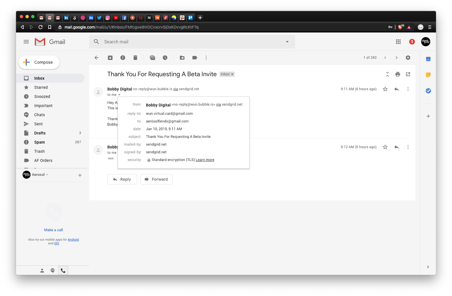

So I just checked my emails and it looks like it started working again about 6 hours ago.
Looks like the emails are processed via sendgrid. Do I need to set up a sendgrid plugin?
