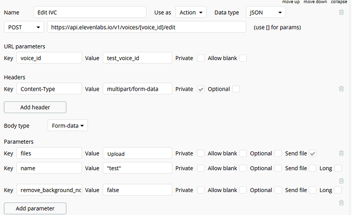

Hey!
I’ve stumbled upon the same issue and I have found the following workaround specifically with ElevenLabs.
You can create an additional call to “edit” voice, which allows uploading new audio samples.
This way you can upload multiple samples for the voice.
