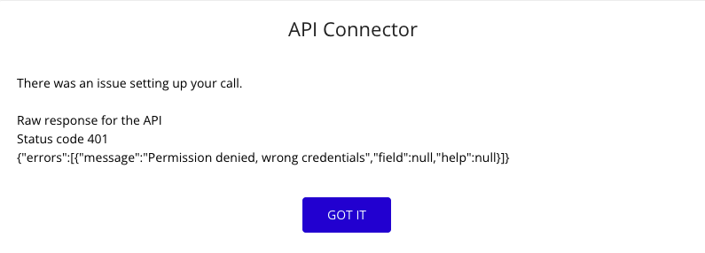

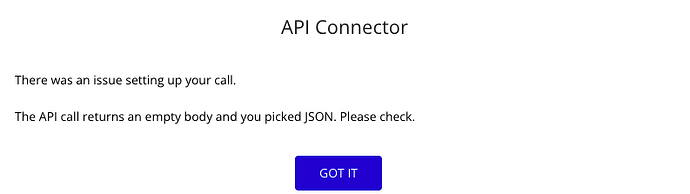

Now the issue is: I am getting errors in connecting with the Bubble API connector.
Bubble error message
Setting
What should I do?

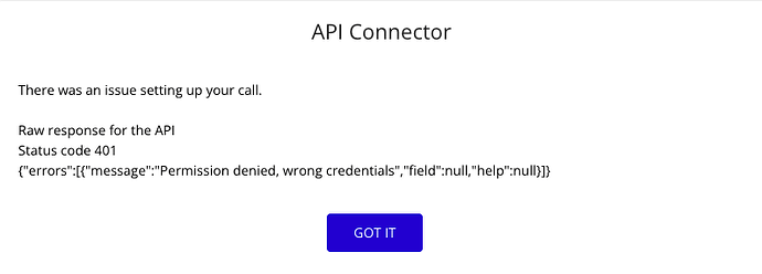

I don’t think you need : after Bearer
Hi @Jici
Without :
:bear:
Change data type to Empty.

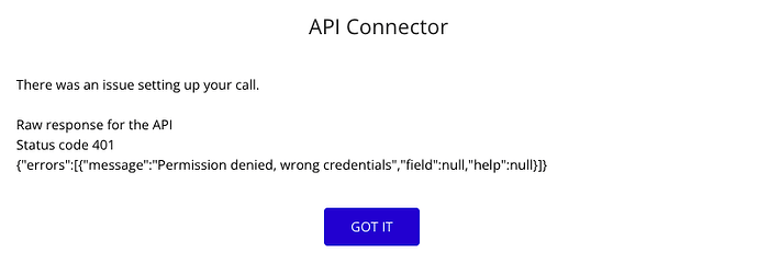

@Jici
Same error
Can you share what you have set in API Connector? If you set the : back, it won’t work.

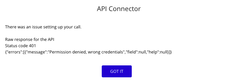

With :
Same error:
Same configuration in Postman and it’s working

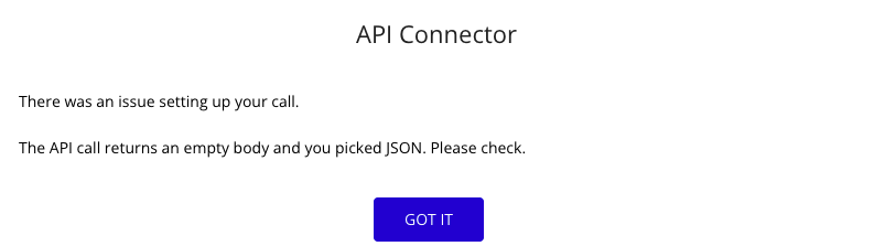

No… you need to remove the : after bearer
And set the Data type to EMPTY
Strange, It’s not working

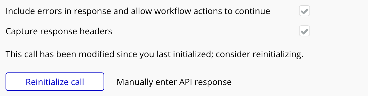

I clicked on initialise without any response, then the button changed to reinitialise call
It’s working. Sendgrid doesn’t return anything else than 200 code. So it work
It’s working

I am trying to connect the Sendgrid API KEY in Bubble email setting
Error message

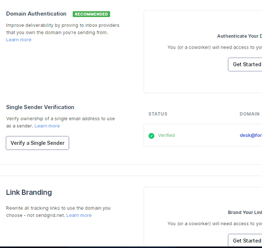

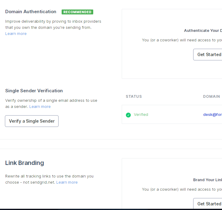

Although, i have verified the identity and as you see it’s working in API connector
Sender identity is normally set in sendgrid account. Did you set the whole domain or a specific address to be allowed in sendgrid?
Specific address to be allowed in SendGrid
Can you share the validation screen in sendgrid?

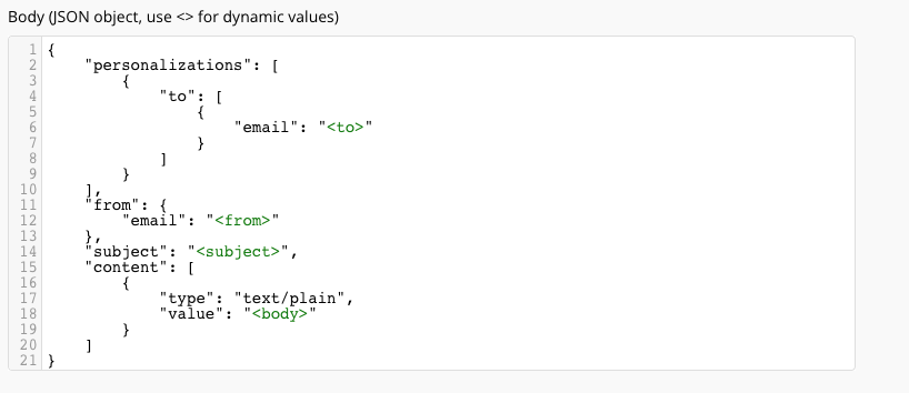

I don’t see any issue in Sendgrid. What did you set in API connector for this request?

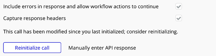

how about checking these chekbox when you initialize?
