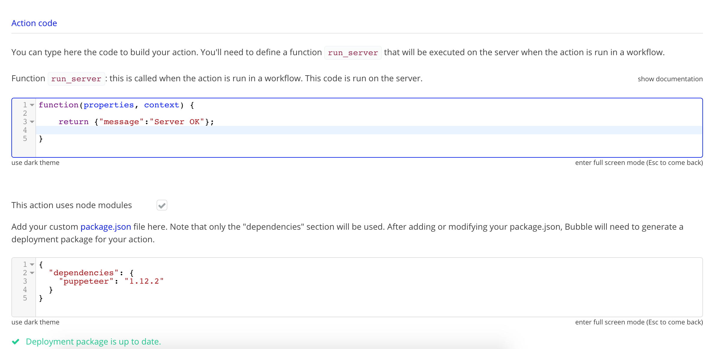

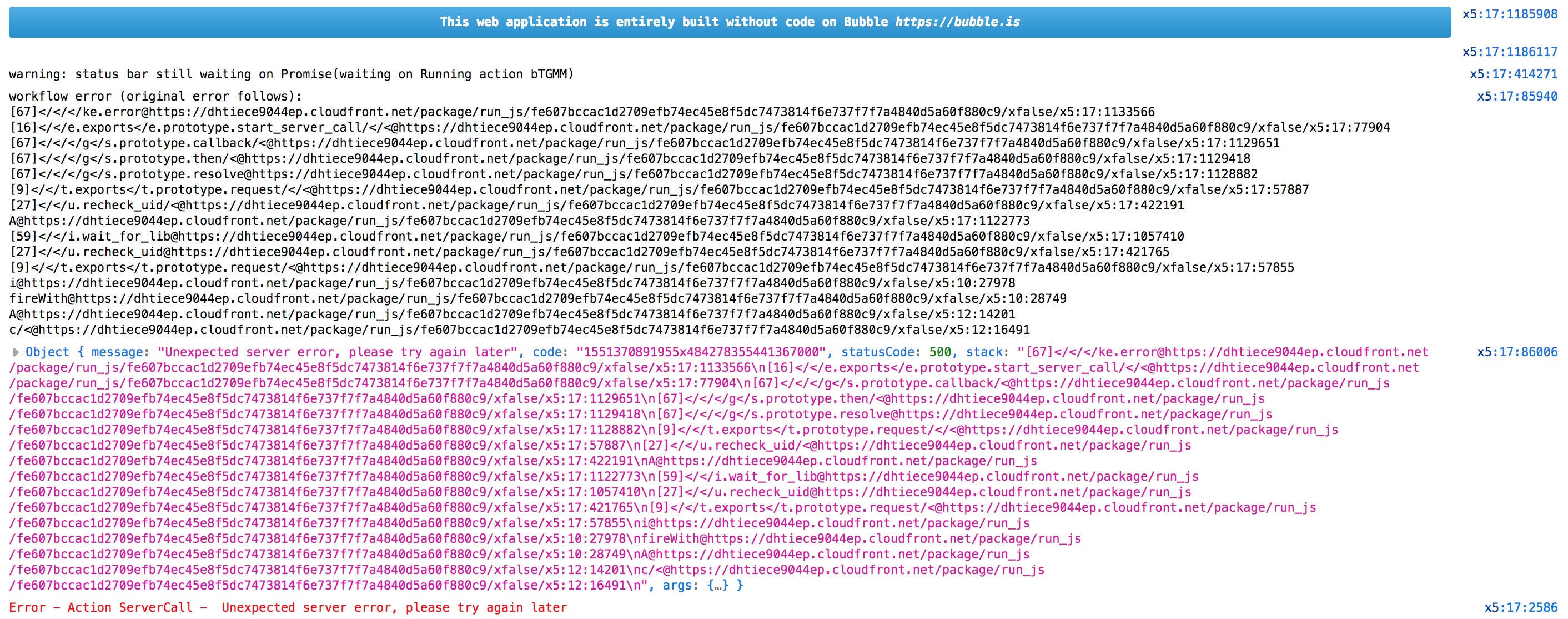

I tried my first server side plugin but it does not seem to work: once I add the puppeteer dependency, the plugin hangs on run. It works with another dependency like moment though.
Any idea?

We have been investigating. Thanks for sharing the plugin and test app.
Our engineers investigated the bug report. This module’s size, which is approximately 325mb, exceeds what our system can handle. Server side actions is intended for lighter, simpler functions.
