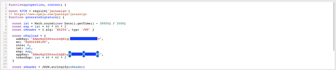

Here’s the code that works and outputs the signature I need on playground. Then when I put that into a server side action on plugin struggling to retrieve the signature I need to then be put into a client side action that let’s them join the Zoom meeting.
@jared.gibb So for complete clarity:

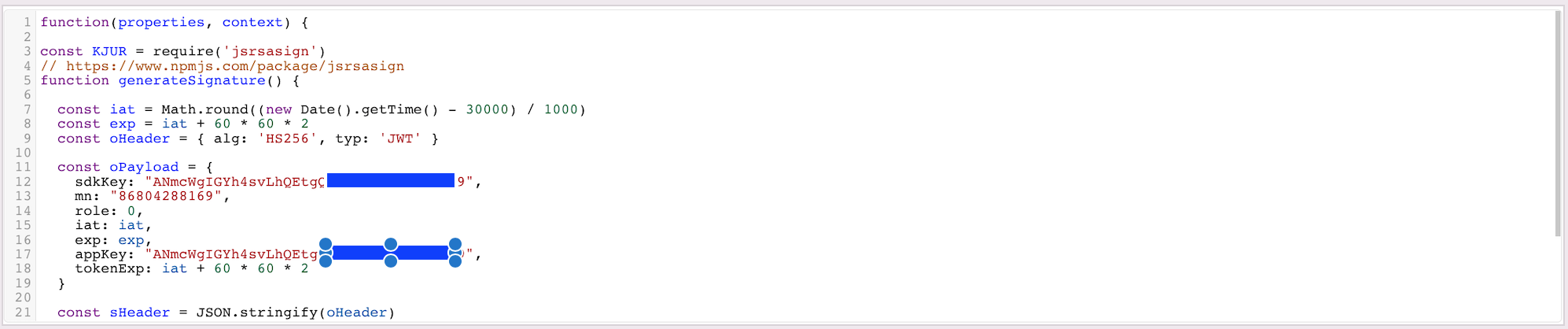

In playground I have the following:

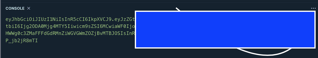

In this environment it successfully generates me a signature (what I am trying to create):

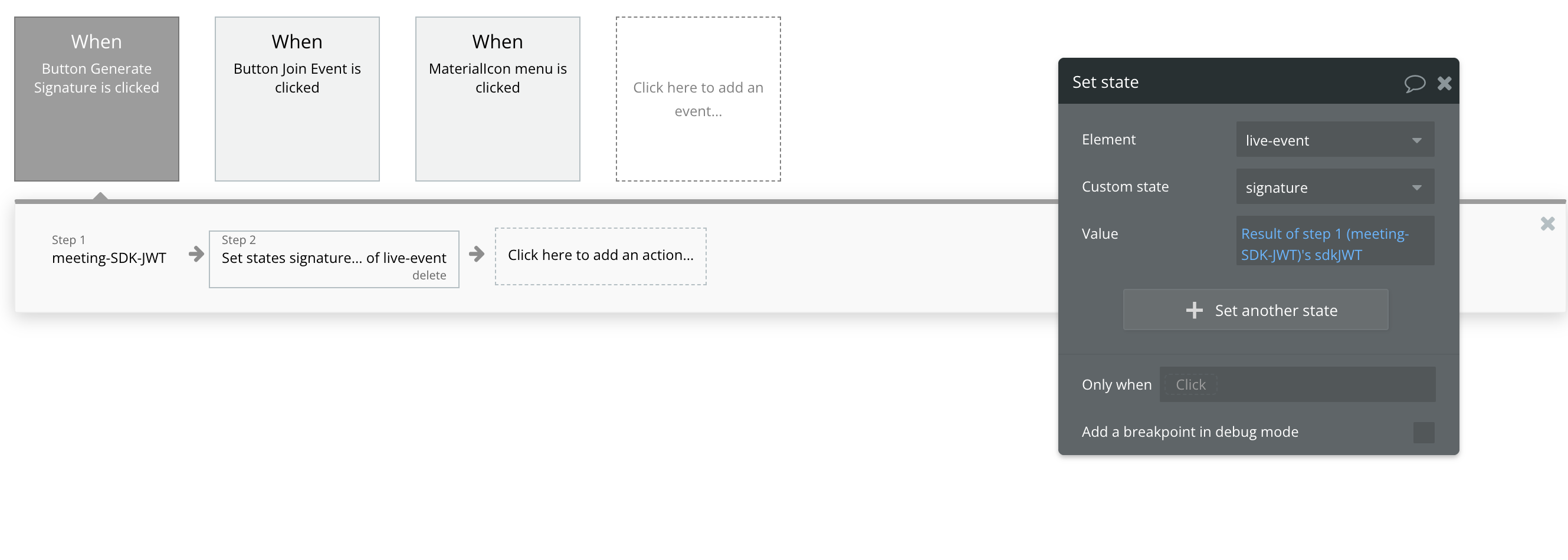

I am then taking that code and installing it into a Server Side Action in the Bubble plugin editor between the required function(prop…) {}, installing the correct node package and setting a Returned Value of sdkJWT:
I am then setting up the front-end workflow to trigger this action on button click with a second workflow step that sets the state of the page with the sdkJWT returned output:

There is no env variables in SSA. Actually I’m not sure if you have process at all.
If you need to pass secrets yoou need to use the “additional keys” in the “shared” section of the plugin. You can choose to have the key public or private and you can access them like this context.keys.yourkey.
Also you need to return something from the action.
You cannot return directly a value. You need to return the parameter value using something like:
return {"sdkJWT": sdkJWT}
It looks like it’s returning a value from the internal function generateSignature, but nothing from the action.
This was it! Thanks Jici!
Thanks Dorilama, yep you were write - had to define the variable from the function and then return it in the way Jici shared
tip for the future: bubble actually tells you what should it be the return object for backend actions, updated with your return fields. It’s visible when you click “show documentation” :slight_smile:
