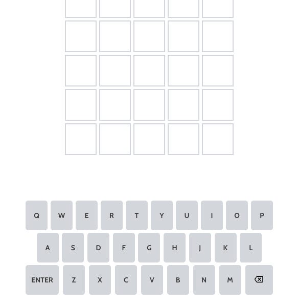

I’ve built the first stage now which is just the ui layout.
Next step is the workflows.
Hey, looking good :slight_smile: keep me updated for the workflow, I’m curious to see how you will do it. Nice job!
here is my write up of how I set up the UI layout so far.
next articles will cover the logic
Hey, so here is my last attempt at a Wordle look alike. I tried many ways to make a virtual keyboard but couldn’t find something really satisfying. Now i used the database so that when a key is pressed, the corresponding letter is stored. And then, square number 1 is related to data #1, square number 2 to data #2 etc, until 30. But the problem is it can only be one player at a time, otherwise it doesnt work. ahah And to change the word, you need to change the conditions for every 30 squares… So quite a challenge to make it perfect, not sure it’s possible with 100% nocode. Curious to see how you takle it !

I’m making progress, and have been focussing on getting the input working from both the physical keyboard input and the onscreen keyboard causing the same result, which I’ve got working with a little javascript and the toolbox plugin. Next will be adding support for the delete key, then on to multi row support, then adding a list of valid words, then other things like transition effects.
Adding content to my write up too, so it’s been a little slow…
