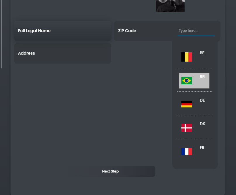

What I am trying to do is set the input’s initial content on the choice made from the repeating group. I have been trying to do this with custom states but for some reason I can’t get it working, when I try to make a choice from the dropdown list, the input’s content remains empty. Please see some images below of my settings

How it looks live

I have set a custom state as text on the input and this will be activated when you click a specific cell on the repeating group, in each RP cell there is a group with an flag image and country name, however I just need the initial content of the input to change in the country name

Hey, I got it working. It wasn’t working because you had a conditional on the Country Multi Choice Group to only show when the Country Input is focused. So when you clicked on the repeating group cell it unfocused the input first and hid the whole group before activating the workflow. You may want to use another method from the one I used to show and hide the group but at least now you know what the error was.
