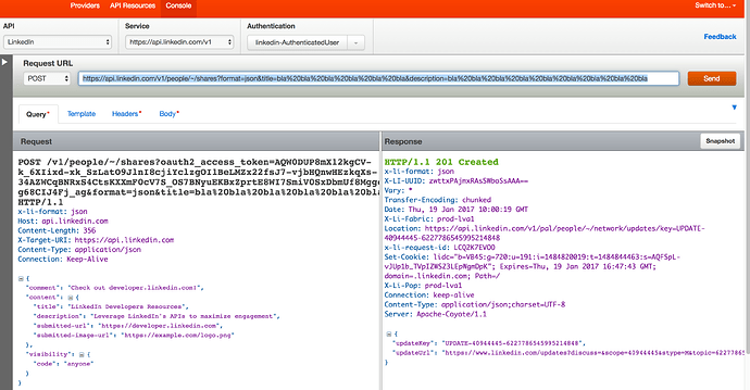

@emmanuel Could you help with this please ? I would like to know if the error comes from me or if there is a bug with the connector.
The reason is it works perfectly from the Linkedin API console, see below.

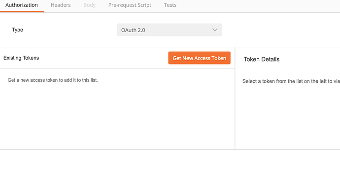

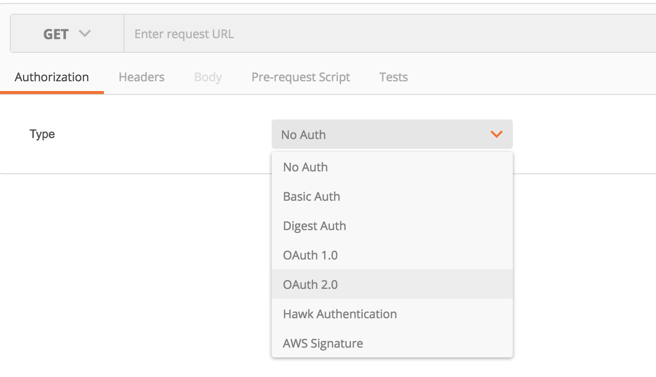

why don’t you test it with Postman first?
It’s very closely resembling the structure of what and how you could be sending from Bubble API connector, so if you got it to work in Postman, it should be downhill for setting it up on Bubble (assuming it’s using the supported interface algorithms).

Yes, this is clear.
But Postman is not a third party tool SaaS that you will need to include to your flow - it’s a tool that will exactly help to cross-check your question, and that’s it.
If you can successfully model, execute and get the right response from Postman, this should work with no issues on Bubble, taking my previous comments into the account.
I use APIGEE (now Google), the most brutal API test environment I ever saw…free. I posted a snapshot above, yiou may have missed it.
For info : https://apigee.com/console/linkedin

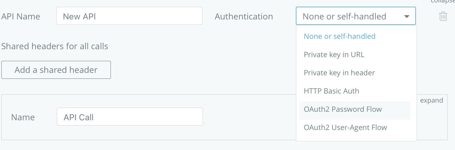

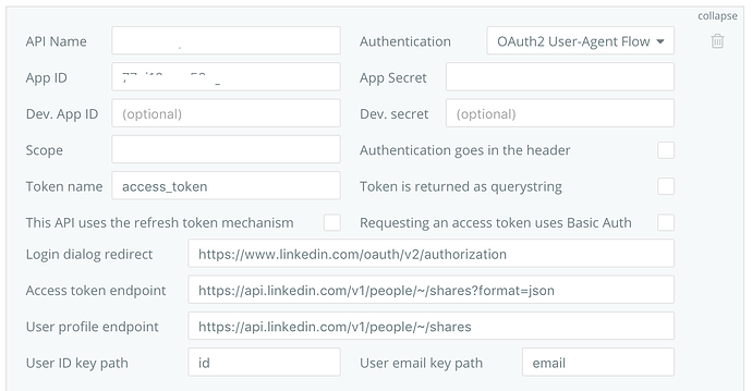

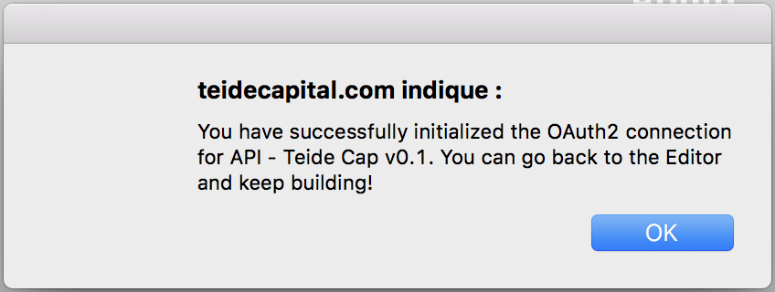

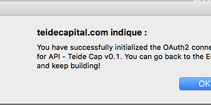

I successfully managed to plug OAuth 2.0 now. However there is a BUG in Bubble. You can connect but call is not initialized.
The issue comes from the POST with w_share scope that does not go throught.

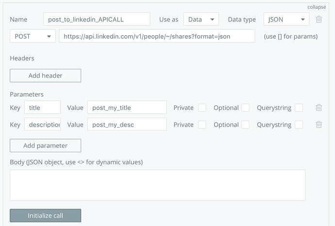

Below are my settings:
Below is my POST call…that does not work. Pls help!

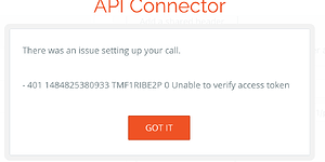

Error:
BUT
“Unable to verify access token” is a linkedin message, not Bubble, so it has to be on their end.

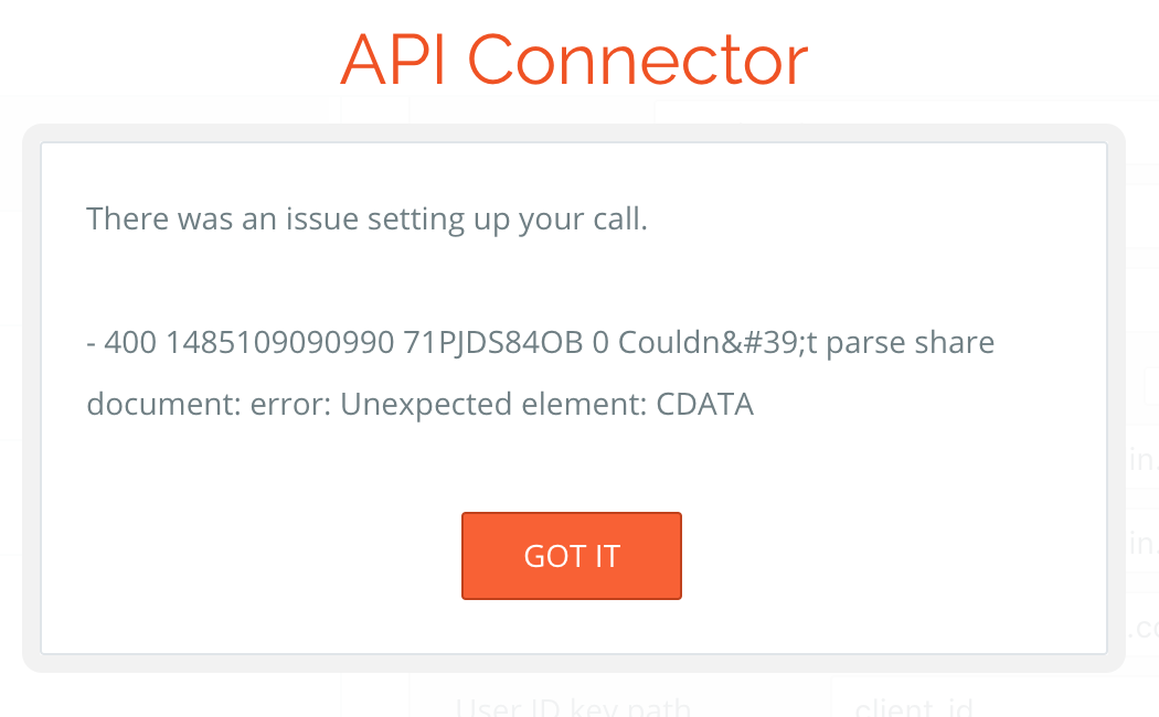

New error however when I try to initialize the call : PLS help, I found nothing about this in the forum
This message is not from Bubble (except the “there was an … call”), so the issue is returned by the service you’re using. I know this is a little frustrating as a process, but when a message comes from a service outside of Bubble we can’t say much. It’s probably worth checking their documentation.
