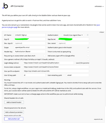

Here’s my API Connector settings:

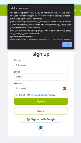

And here’s the error I get after signing in to LinkedIn:
Thanks🙏
In user id keypath, set sub instead of id
Amazing!!! Works :grin:

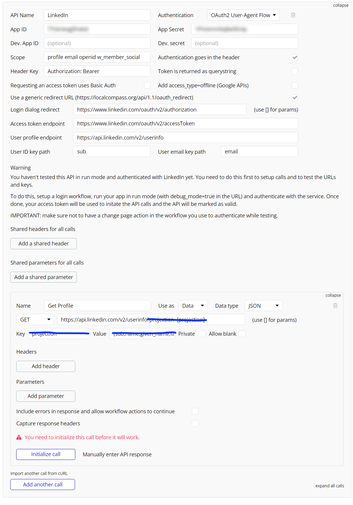

hi Julian. How did you solve it? I’m able to successfully sign up users from Linkedin but I can’t get the GET call to retrieve user info to work. Please have a look at my settings here. I can’t initialize the call and always get the error message attached

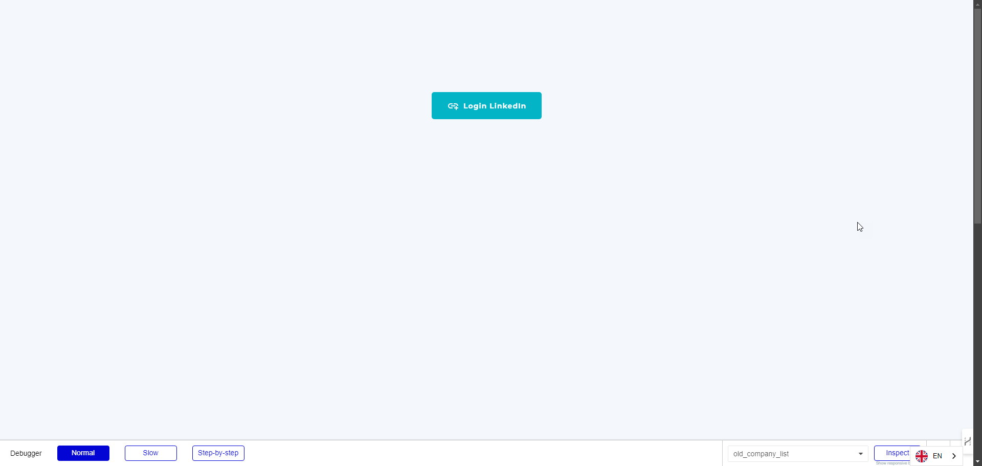

The first step is to initialize the auth. Look at the message in the auth section. Create a dummy page with action Login with social network in debug_mode to initialize the auth. After that, you will be able to initialize API call.
As @Jici says. :grinning:

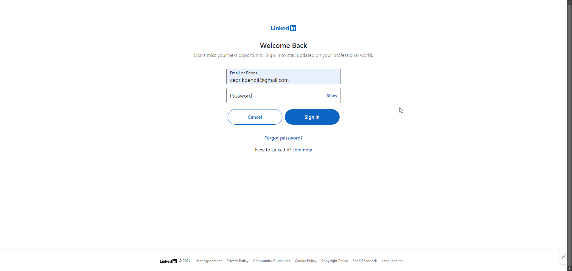

I tried that. As you can see in the screenshots below, I was able to authenticate. Although i receive a bubble message saying “this user already exist” as the email associated with my linkedin is already a user in my APP. But after all this, I still can’t initialize calls. Is there something I’m missing?

I am no expert with APIs but here’s what I see different in your set up compared to mine.
I hope this helps!
It’s working now. I don’t know what was the issue. All I did was reordering the order of the parameters in the Scope.
