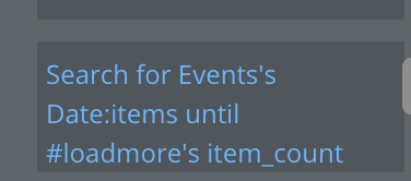

You can set a state on the page, something like item_count of type number.
Then in the repeating group data source use items until # → have it reference the item_count state
Then on your Show more button, just update that state with something like +3

Items until# should appear on the dropdown anytime a list is being referred to. In your screenshot you’re looking in the wrong place - you need to apply it to the datasource, so click the ‘more’ button after the ‘Search for Groups’ in the data source (you’re specifying the ‘items until’ of the returned list of groups - nothing to do with the search constraints).

i.e. Search for Groups: Items Until (custom state value)
Then when the ‘Show More’ button is clicked, set the state to its current value +8

You have to refer to the element it’s on first (in your case the page itself). So Search for Groups: Items until: my page's item_count

Thank you, I have now referred to the custom state in the data source .
list
Despite setting the default value to ‘1’ I still see ALL groups.
I see what I was doing wrong, the button was not referring to the index page custom state so it was asking me to create a new one. I have now added the workflow to the button (below) but of course nothing works because the RG is always displaying ALL groups.

I have made progress! I set up a new test page and got the ‘show more’ function working. I think the issue I am having on the main homepage is with the dropdown conflicting with the ‘show more’ button. I’ll have a look at applying custom states to the dropdown tomorrow and see if I can get it working better - but thanks for your help thus far!
UPDATE: It works! The default “Select town” dropdown references items until# item_count but when you select “All UK” from the UK it no longer references the custom state and simply shows all.
