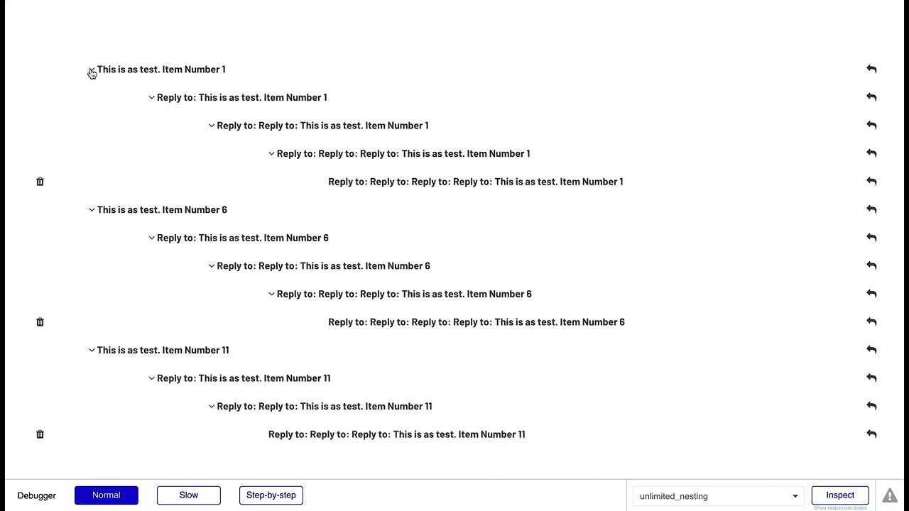

I had to do some workaround - but i did it with only one RG!!!
How it looks:
Thx Aaron - your idea got me really close to solution and 8h later i got it to work. :slight_smile:
Editor Link:
Preview Link:
Let me know what you think guys.
Any idea for better performance?
