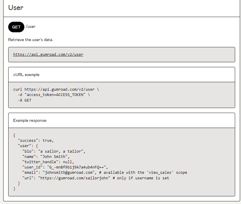

This call (see image), is the call for the “user” endpoint?
Like this on from Gumroad ?
@mick.bourgois that’s correct

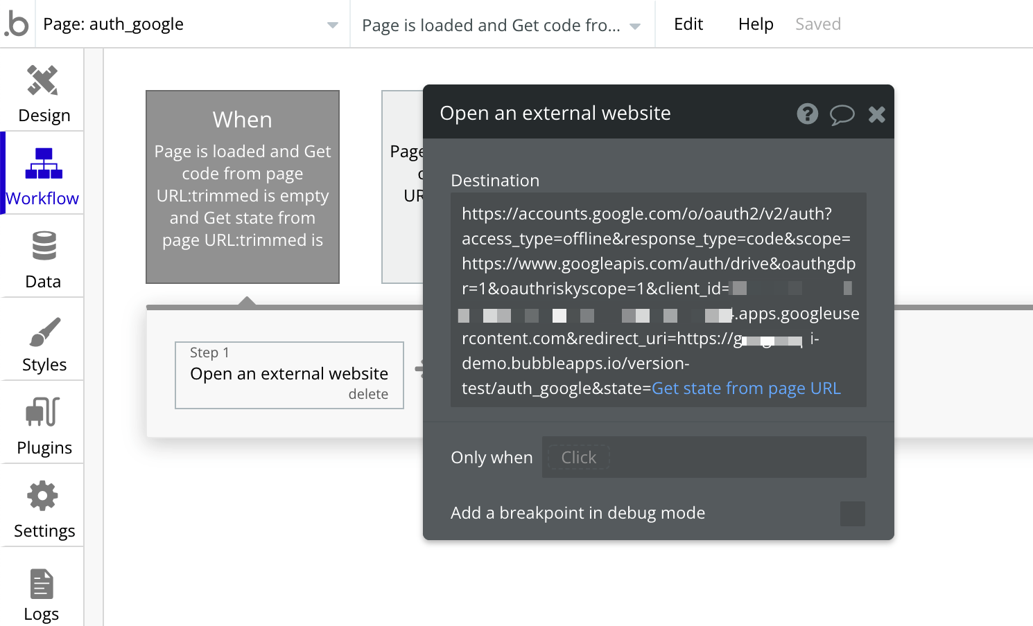

  2. In your 2nd screenshot (below), you’re using the wrong URL.
This URL should not be used in an API call - it should be the URL to which you redirect the user via the “Open an external website” workflow on your page. You should follow exactly the same approach than step 3.3 in the guide above. Here is an example for Google:
  1. Change the URL in your “Google init” call to https://www.googleapis.com/oauth2/v4/token - same approach than in step 2.2 in the guide above, this will exchange the code for an access token. For Google, it should look like this:

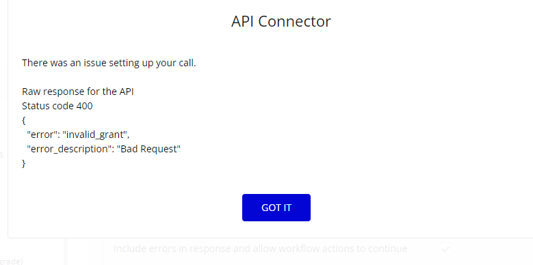

I’m sending the code which i get from user-agent flow to the API “https://www.googleapis.com/oauth2/v4/token”. As shown in below screenshot but it is giving error “Invalid grant type”.
Error scrnshot

I’m able to do it till this.
in this example they are showing demo of Youtube data API’s. But i want the idtoken from google. And for that i’m getting " invalid grant" “bad request” type error when i make below post call
What can be the reason for bad request?
