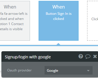

  1. Creating a button, whose workflow is set to Sign In using the Google Oauth provider
But, on-click of the button, I get this:
