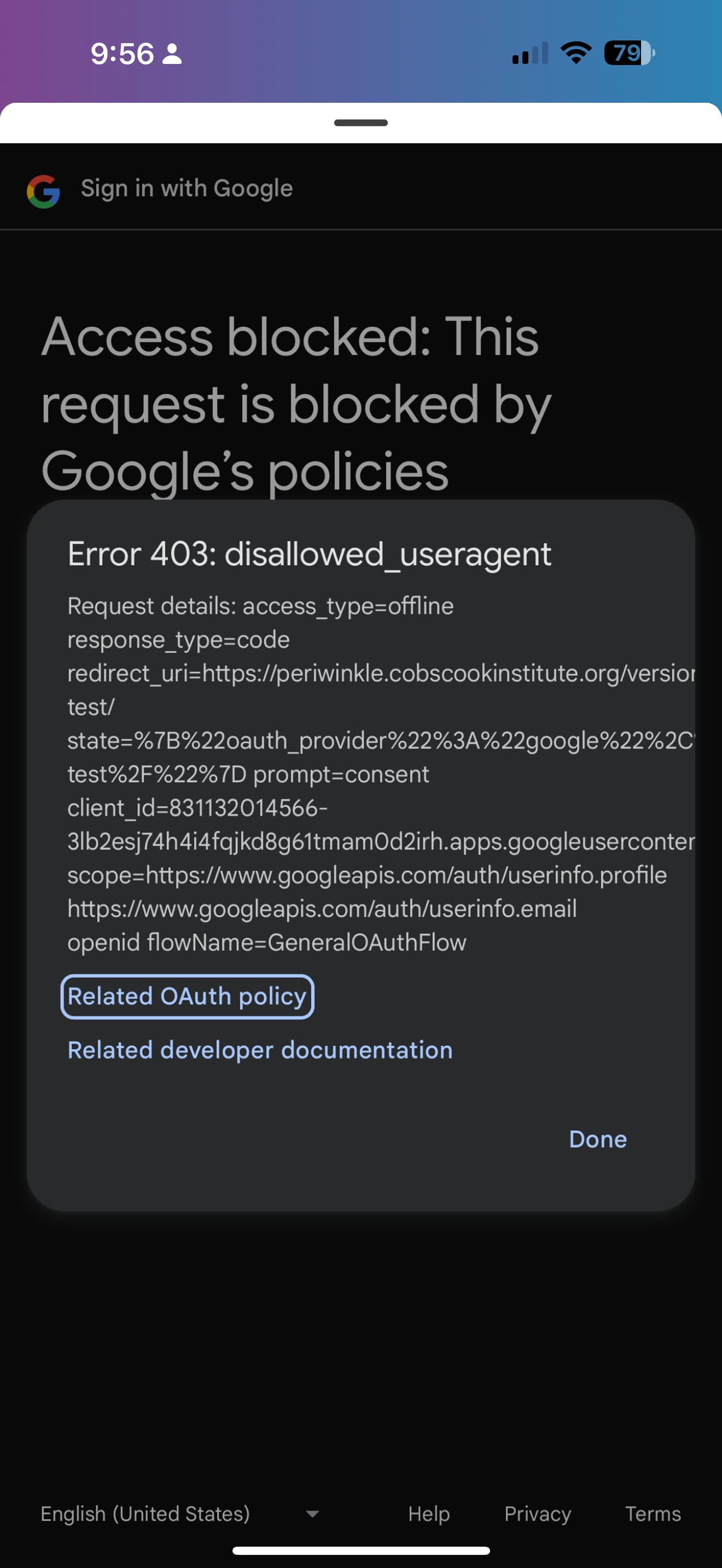

Using the action Signup/login with a social network directly within mobile: returns this error from Google. I only tested this on iOS BubbleGo. I tried using this method last year and had similar issues and was told by support that Google was not supported at the time, so I wasn’t expecting this to work:

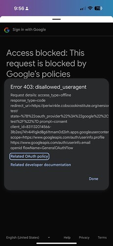

Using a web view with a page that has the Signup/login with a social network action: @mario11 I believe this is the method you mentioned in the other thread, but I’m not sure. I only tested this on iOS in BubbleGo. I’m using the index of my web app to sign in, which usually works fine on both test and live versions. This method returns this error from Google:

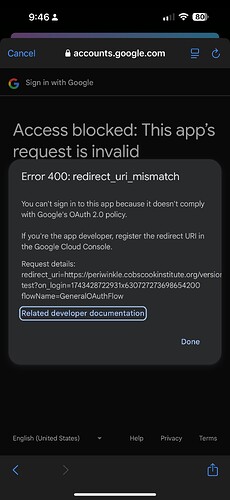

Using the Sign up/login with a web browser action directly within mobile: @nick.carroll I believe this is the method you mentioned in the other thread, and seemed promising since I believe this has been added since I had last tried to get this to work. I’m using the index of my web app to sign in, which usually works fine on both test and live versions. I tested this on iOS in both BubbleGo and within the app deployed through TestFlight. Unfortunately it returns this error from Google in both situations. This is the issue I was running into before, where Bubble is adding URL parameters to the redirect URI, which is not allowed by Google. I can’t find anywhere within Bubble to have it not add these parameters.

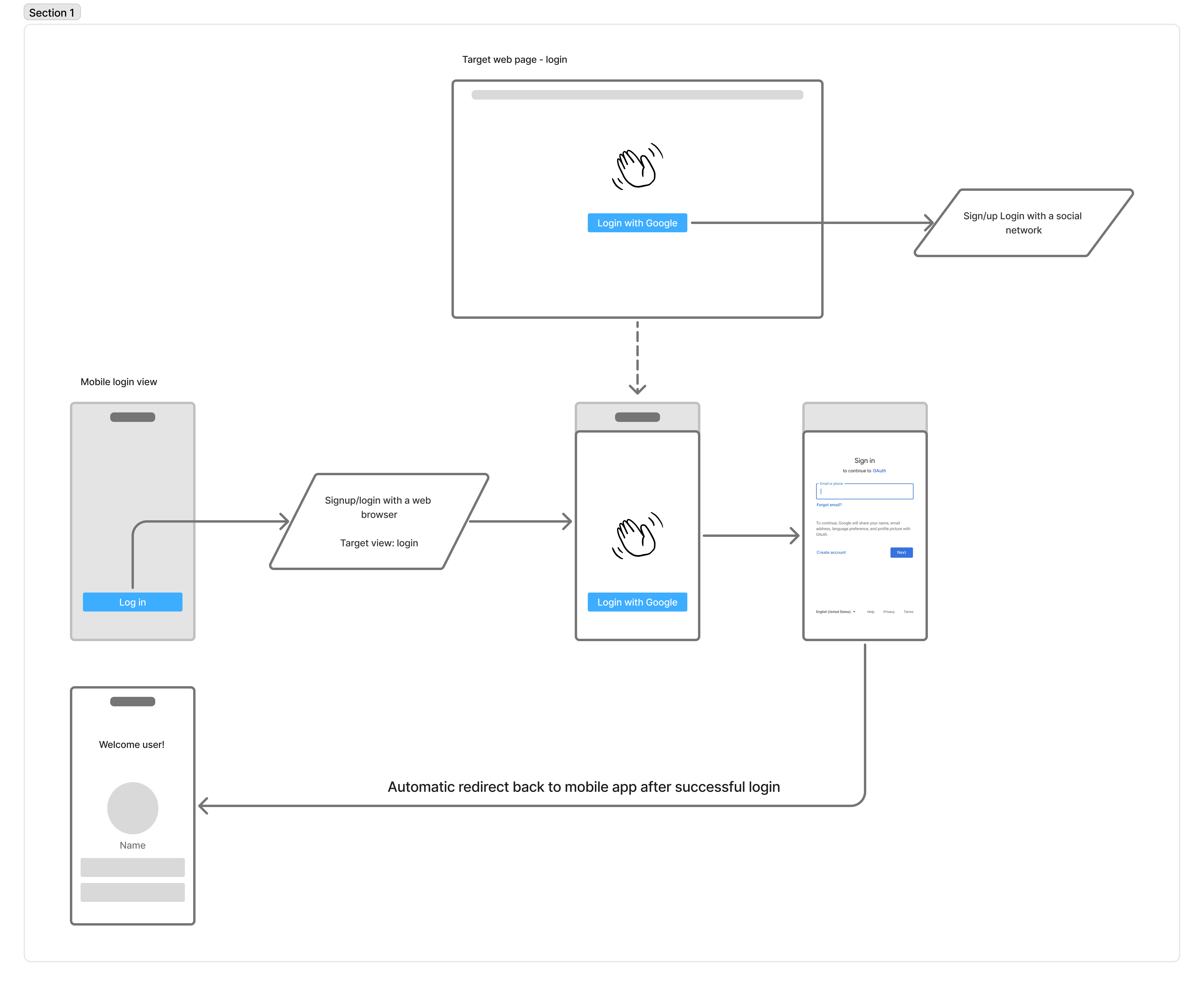

This is the general setup for using signup/login with a web browser on mobile and oauth 2. Lmk if this helps at all
That’s the third scenario I described above. I’ve implemented it the way it’s laid out here, and it gives me the redirect_uri_mismatch error when running the “Signup/login with a social network” action on the page that I’ve entered into the “signup/login with a web browser” action.

Then I get this error, from Google:
Bubble is giving this to Google as the redirect_uri, only when running it through this flow in the mobile app:
https://periwinkle.cobscookinstitute.org/version-test?on_login=1743428722931x630727273698654200
Normally when signing in with Google on the web version of my app, on the same page that I’ve put into the “signup/login with a web browser” action, it just give this as a redirect_uri to Google: https://periwinkle.cobscookinstitute.org/version-test
I’m not sure where the “on_login” parameter is coming from. I didn’t add it, and it seems like Bubble is adding it automatically. Google doesn’t accept variable URL parameters in the redirect_uri, so it’s not possible for this to work.
