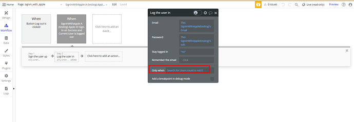

Thank you for getting in touch! We appreciate your feedback and understand your concern.
If the user already exists, simply proceed with a regular login; thereās no need to modify or remove any data. However, if the user is signing up for the first time, they can use the Apple ID login option. We have provided an example of this on the pluginās demo page. Allow me to share a screenshot to illustrate this.
