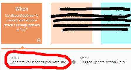

The page has a workflow triggered by the calender-x icon being clicked.
The first two steps of the workflow are simple.
1. Set the value of a custom state to empty.

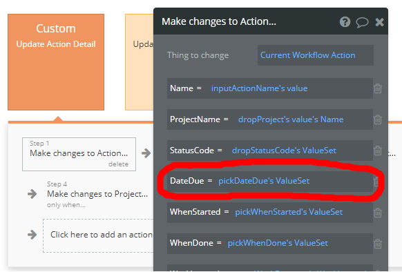

  1. Trigger a workflow in which the first step is Make changes to a thing. Among other fields updated is DateDue which is set to the value (empty) of the custom state set in step 1.
After execution:
the custom state is empty, as it should be,
the Action thing still contains its non-empty value, not the empty value it should contain,
the page still shows the non-empty value.

If you wait a few seconds and click it again, what happens? What does that tell you about Bubble executing workflow steps out of order?
Update:
I have dramatically simplified the page in question. There are now two versions reachable by either the 1 or 2 link on the index page.
Version 1 is similar to the original, but I’ve done my best to remove any extraneous workflows and actions that might confuse the issue.
Version 2 brings the workflow action “Make changes to Action…” up a level. This way the timing of its execution isn’t influenced by being in a triggered workflow below the element “is clicked” workflow.
Please refer to the first post of this topic for a deeper explanation of the problem. The key difference is that accessing either action-detail page is done by clicking the 1 or 2, not the Action name.
The problem remains in both versions. It is as though the second step is allowed to execute before the first is allowed to complete.

There was indeed a bug with the workflow engine with the way an empty value for a custom state was being applied to following actions on the server. It was particular corner case but real.
We pushed a fix, sorry about that one, I know it was frustrating.
