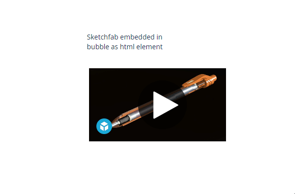

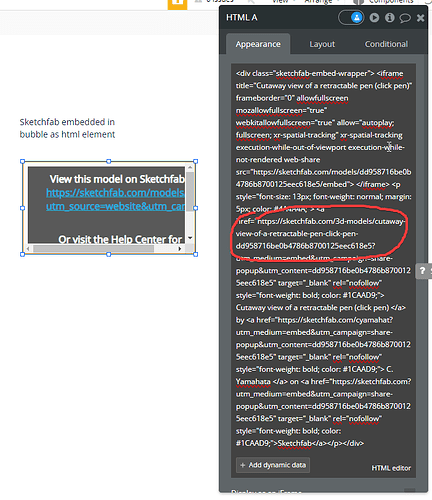

@Jici is right. Maybe explain what you are trying to do. As far as I see, ViewerAPI is just viewing models in a page. If you are just trying to do that (view sketchfab models in your page), you can just embed them in your bubble page using html element:
Every model has an embed code, but most parts are same and you just need to switch IDs or URLs:
