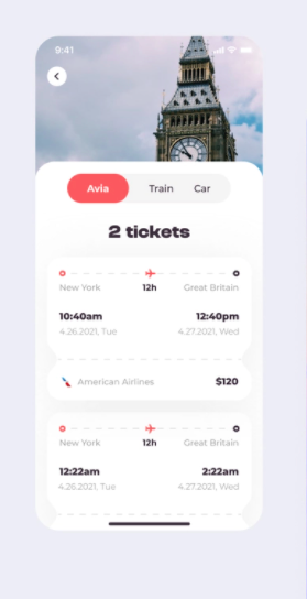

Guys is it possible to have a screen slide up/down on mobile like this?
Yeah.
- create a floating group that covers the full screen and anchor it to the bottom
- on button press - animate it with no bounce slide up
