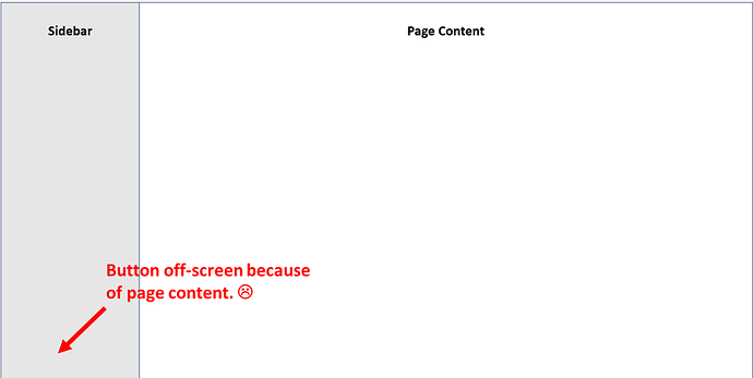

Greetings, Bubblers! With the power of the new responsive engine, I’m guessing there’s a way to achieve this, but is it possible to make a sidebar that fits 100% of the view height but the “page content” can scroll freely? I can’t seem to make it work. Here’s the problem I have currently:

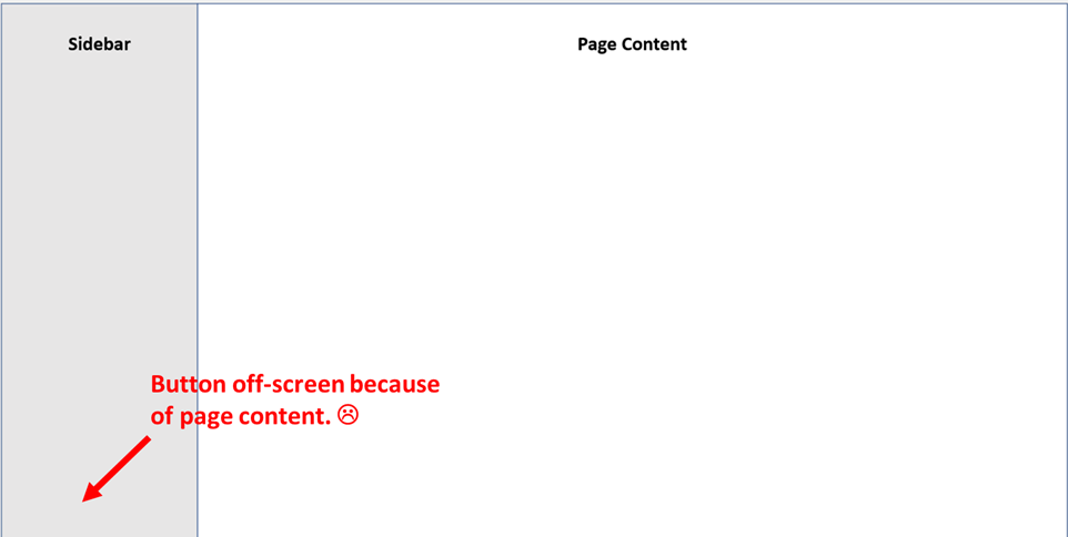

Thanks for that, @sudsy! Definitely is helping me get closer. I did notice, though, that this setup doesn’t seem to work when the “content” area extends off the screen (unless I’m missing something):
2022-01-03_11-52-13
Any ideas?
