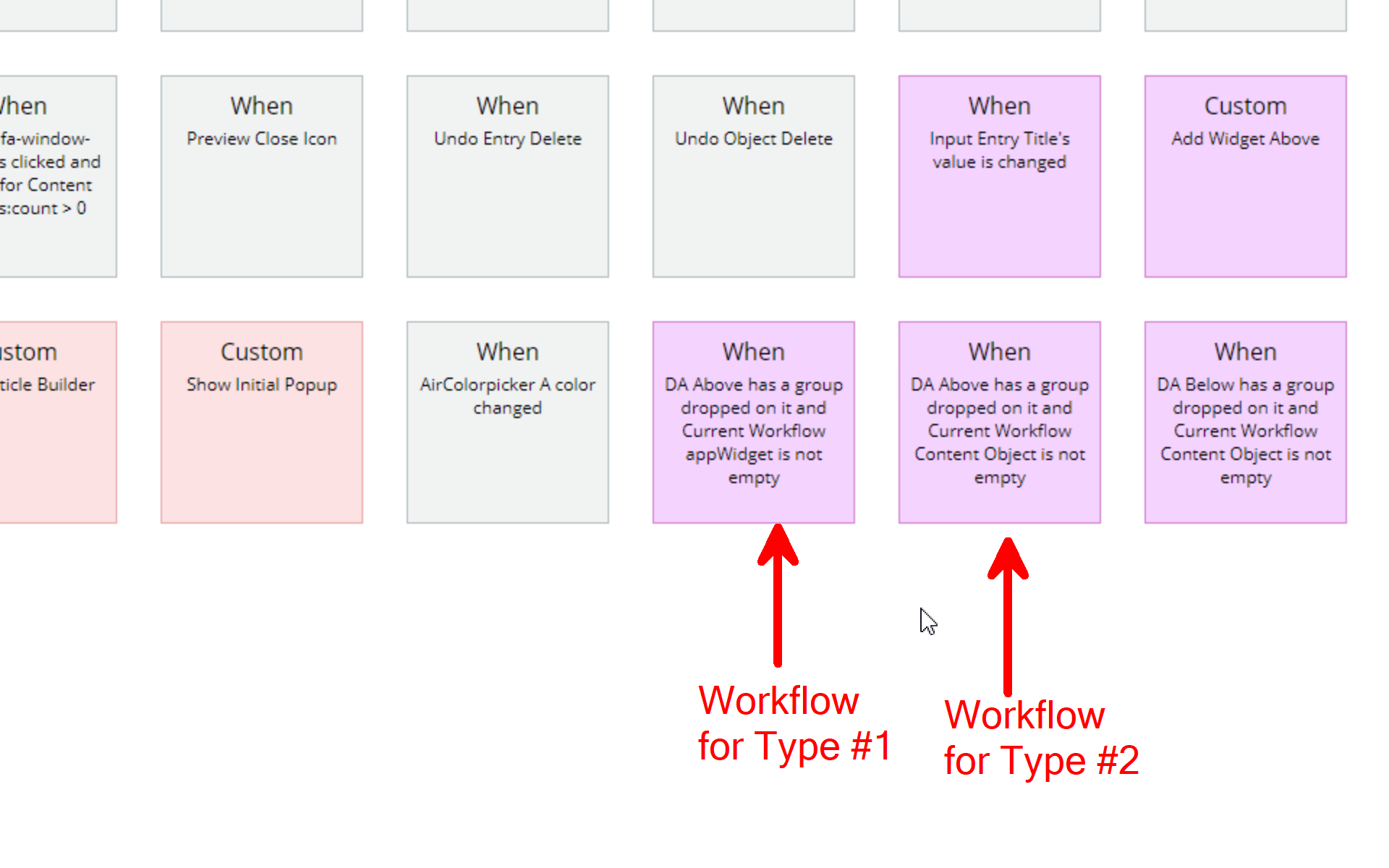

Does anyone know of a nifty way to work with different types of data for drag/drop zones? I have two drag object types and need to be able to drop them both on the same drop area/zone. However, every time I try to do so, I get the following error with the second workflow for the other data type not being used:
There is a type mismatch between the dropped group and the workflow type
Here’s the Workflow view; depending on what’s dropped, I get an error for either #1 or #2:

Drop areas do work with different types of drop items even if the drop area’s type isn’t the same; I simply needed to put another workflow in place that had a condition that checked if the dropped item was of a different type.

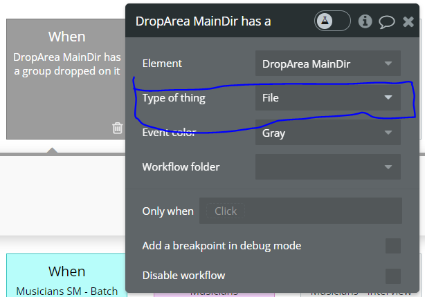

I’ve been having the same issue, and can’t figure out how to check for the different type.
How did you “put another workflow in place that had a condition that checked if the dropped item was of a different type”?
Just dropping this here in case somebody is looking for a solution. You can choose the Type of Thing inside the event.
