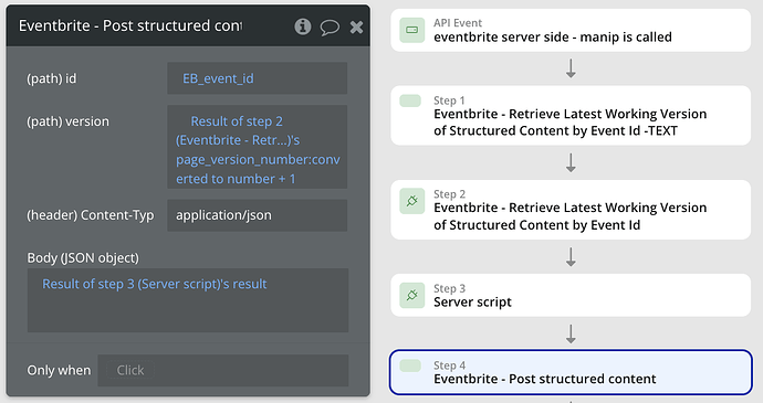

    CleanShot 2025-05-19 at 11.31.27@2x
  • Save the response as a plain text field in your database or pass it straight into server script.
  • Use Toolbox’s “Run JavaScript” in a backend workflow to parse, modify, and rebuild the JSON.
  • Send the final result wherever you need — re-encoded as JSON.

I had to do a normal GET request to also be able to bump the version number. Other than that I posted the JSON body as a raw body back to eventbrite. All works fine.
Bubble’s API Connector must receive structured content as text, not JSON, if you want to parse and manipulate it. At least from the Eventbrite API as far as I can work it.
I tried sending it off to AWS Lambda, Make, and even Zerowork — nothing worked. It wasn’t until I discovered that I had to receive the JSON as raw text in the API Connector that things finally clicked. Thanks for reading, I hope it can help you with something.
