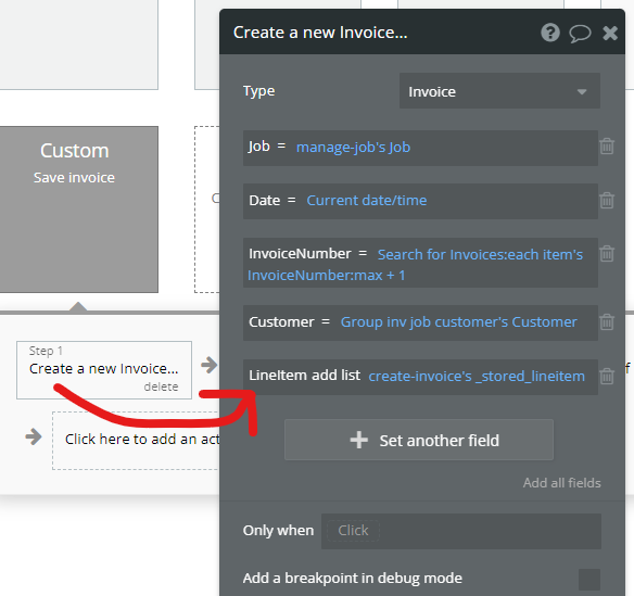

This works and now the lint items each show in individual rows, whilst the Invoice data type only display one consolidated row. Can you help me understand the logic here though because we are making changes to the LineItem datatype by referring to the Result of step 1, but step 1 doesn’t mention the Line Items as that only creates the invoice! I need to get my head around this!
In short, this is the actions we are taking to create an invoice (with line items);
  • Create a new line item and save to custom state _stored_lineitem .
  • Create a new invoice and make changes to Create a new invoice’s Lineitem.
What I don’t understand is how the ‘Create a new invoice’s Lineitem’ works because at this stage the Invoice doesn’t know about line items? I’m not explaining clearly, sorry, but I’m curious how the invoice ‘knows’ it has line items.
You’re adding the line items in step 2 (although I’m not sure why you need two steps - you could do all in that in step 1)
But you’re referring to the Actual invoice (which you created in step 1 and modified in step 2 - but it’s still the same invoice), so it shouldn’t matter which step you refer to (although it might be safer to refer to step 2’s Invoices line items, just to make sure the line items are added to the invoice when you’re trying to make changes to them).
Alternatively, you could refer to the Line Items stored in the custom state (as long as you haven’t cleared the custom state value) - they’re all the same line items.
I don’t understand what you mean by that… what is ‘Create a new invoice’s Lineitem’? I can’t see that action anywhere…
Nothing ‘knows’ anything unless you explicitly programme it in… that’s what you’re doing with your workflows (although I don’t really understand what you’re asking about here)
Very true. I have just removed adding the line items in step 2 and instead added that to Step 1. Note that Step 2 is used to convert the invoice number to text because I understood that this must be done in a separate step.
Sorry for my poor terminology. I was just referring to step 3 in the ‘create invoice’ workflow (see below). I make changes to the Lineitems by referring to Step 1 - but step 1 never had any mention of Linitems so I wondered how it could make any changes. I know why I was confused by this, I had forgotten that Step 2 referred to the lineitems so that answers it for me.

That’s the whole point of the ‘make changes to a list of lineitems’ action - to set the Invoice on the line items…
but you’re not doing it at the moment (this action is doing nothing in your workflow at the moment)…
You need to set the Invoice field on the line items to be the result of step 1 (the invoice). So click the Change another field button and select Invoice - then set it to the newly created invoice.
