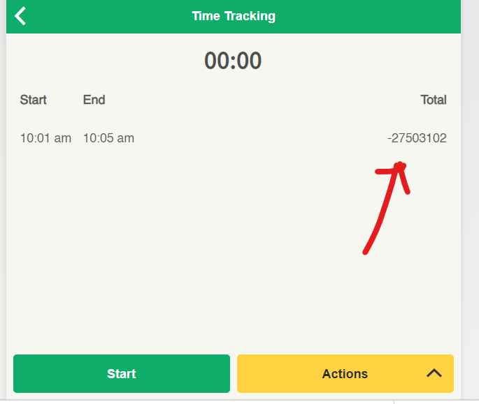

I’ve read a lot of posts about this topic but not found a solution which works for me, this should be a fairly simple calculation?
My workflow takes the end time - start time but the resulting total is a strange long number? Why isn’t this giving me the answer 4 minutes?
Times are stores in the DB as Dates and the total is stored as a number.
If you use ‘format as minutes’ it will show the difference in minutes…
What are you currently using?
Also, the number shouldn’t be negative… so it looks like you’re doing the calculation wrong
Update: in fact the number you’ve got there (assuming it is formatted as minutes) seems to be exactly the start of the Unix epoch minus the current date/time - which should give you a clue as to what’s going on…
So it looks like you’re doing something wrong in your expression (either on the workflow that stores it, or on the element that displays it). Some screenshots of your expression/calculation should help here (although i can already guess what you’re doing wrong from the result you’re seeing)

I also was confused by the fact that the number is negative. I found that if I make the recorded time start time - end time it is not negative, but this makes no sense, surely the time elapsed should be the opposite, ie.end time - start time?

Ahh I see what you’re doing wrong… you’re trying to set the Shift’s End Time in the same workflow action as you’re calculating the total time…
That won’t work (and obviously isn’t working)… you can’t reference a value that you haven’t yet set…
And if you try to, it will be empty, which is exactly what’s happening here… (you should be able to see that for yourself using the debugger)…
So the calculation you’re actually doing is the end time (which is empty, and therefor 0 - or 1st Jan 1970 00:00) minus the start time, which will give you a total number of -27503102 minutes (which is correct given the calculation).
To make it work the way you need it to you need to store the value for the stop time first (before referencing it in the calculation).
So, either add an extra step to the workflow to set the stop time on the Shift first, or (a better option as it requires less database interaction) use a custom state to store the end time, then use that value to store both the end time on the Shift, and for the calculation of total time.
