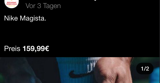

Example1 - Not shrinking with short text:
Bildschirmfoto 2021-08-23 um 09.42.26

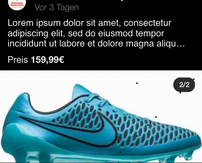

Example2 - Working as it should with long text:
5khuam
In the example 1 the “Text1” that is set to “cut off content” is not shrinking.

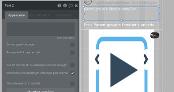

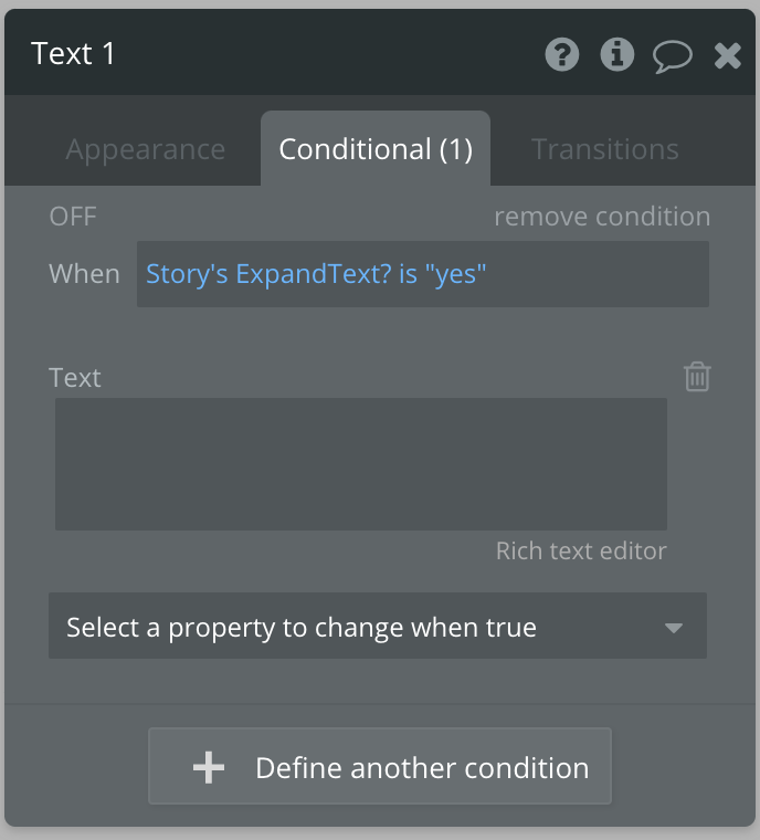

One solution would be if I could use the options “shrink element” & “cut off content” in conditionals or also if the “cut off content” would also shrink the element.

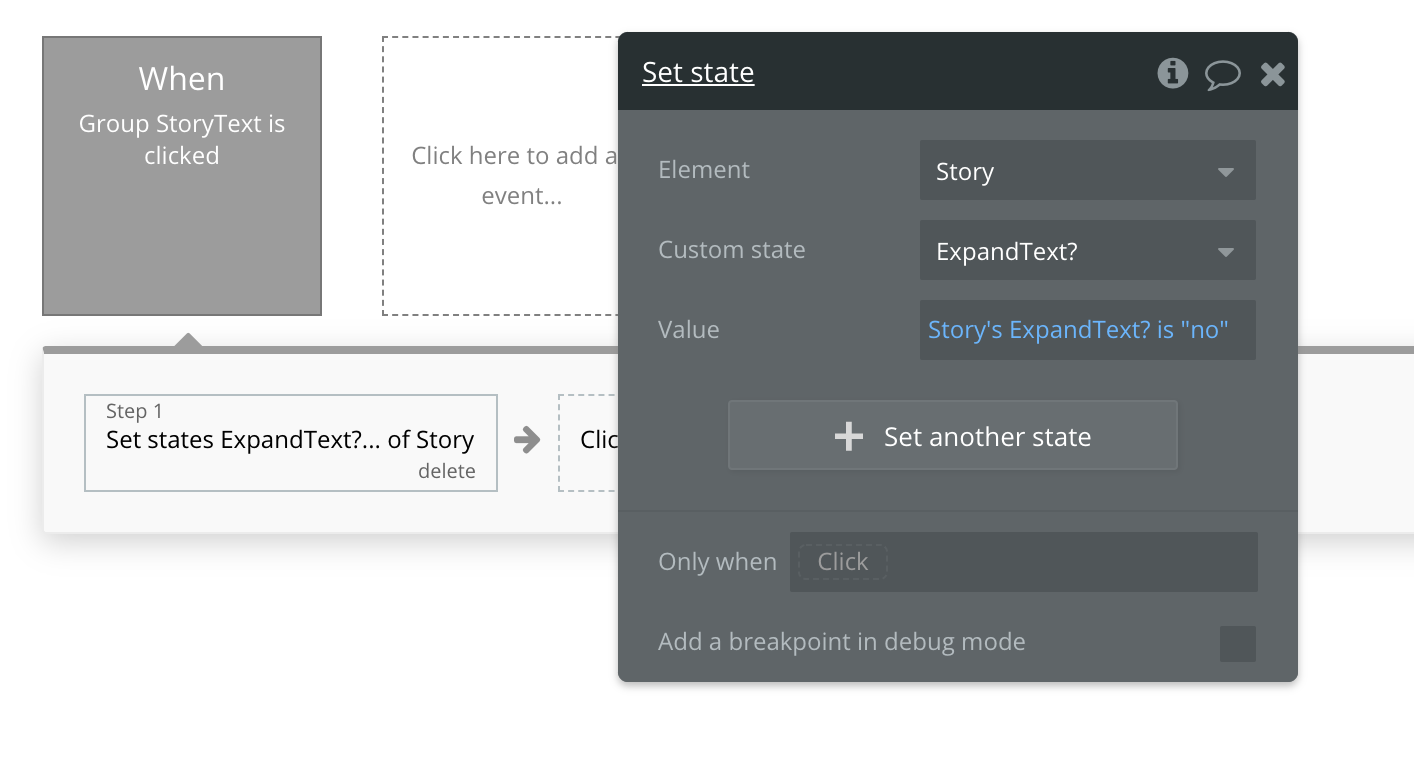

  • Create a boolean custom state (Yes/No) which switches when the group is clicked: When group is clicked - set State - This State is “no”

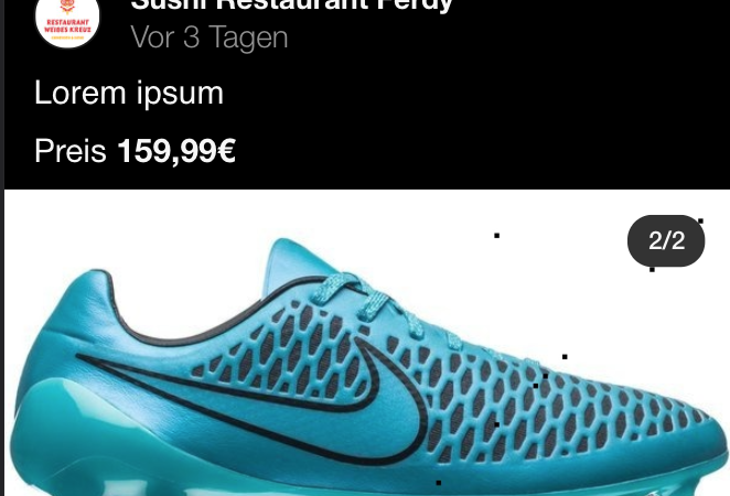

The Result: The text is CutOff to 3 lines if longer - and the element shrinks if shorter!
Bildschirmfoto 2021-08-23 um 10.39.10
