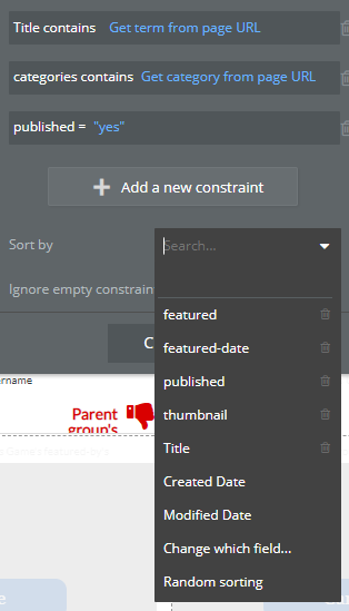

They’re both a list of users. I want to sort a post by the number of likes vs dislikes. The most disliked post being at the bottom of the list and the most liked being at the top.
When I attempt to sort, these lists don’t show up as something I can sort by.

Within search sorting, I do not believe you can sum a list and then use that value as a sort field.
However, you can build in a field that echoes the count of users who have liked (or disliked) the given item. (Basically recorded as “current items like count +1”) within the same workflow that records the like/dislike. (You can use a bulk changes API workflow to clean up your existing data to conform to this).
That should give you the ability to sort based on how you’d like.
try change which field, or store the like/dislike field on the post itself rather than user. you can have disliked by type user, dislike count type number.

the likes and dislikes are stored under the post.
The post stores lists of users
likes are a list of users stored in the post
dislikes are a list of users stored in the post
so I am storing the under the post. I did come up with a compromise by adding a “score” which is just a number stored in the post that gets updated with the number of users who liked minus the number of users who disliked.
