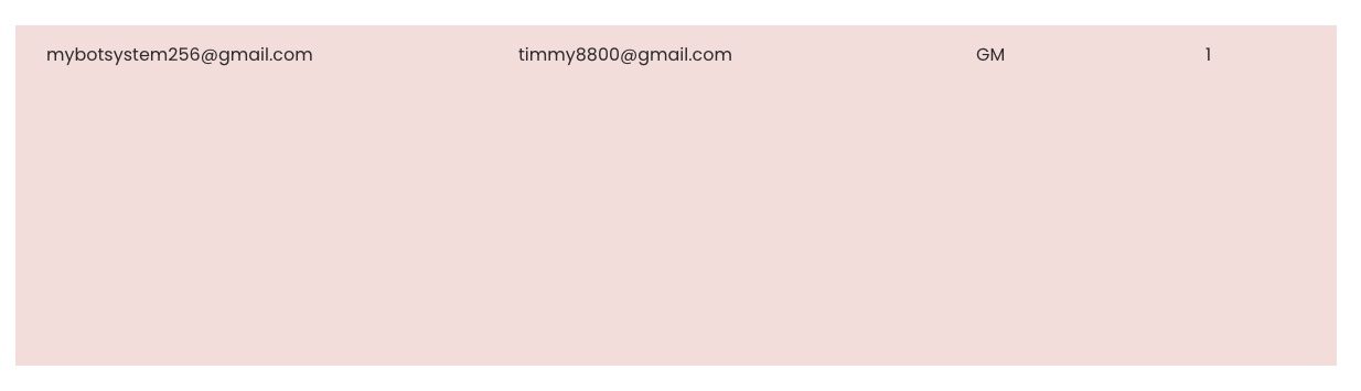

This query works completely fine, returning the 1 result I’m looking for in my repeating group.
Query:
Result:
Of course, I don’t want to hard code my user’s email into the query, so I want to replace the email string with a parameter. However, with just that single change, and testing with the same email that was hard-coded in the first query, the 1 result no longer appears in the repeating group.
Query with parameter:
Configuration of repeating group updated so parameter is the same value that was hard-coded in the test:
Empty repeating group:

This is what happens when I make the change… (I am using mySQL) I get an error from Bubble saying it’s an unknown column. To clarify, account is the column name, and the email string is the value.
Screen Shot 2022-08-28 at 7.34.28 AM
Update: I was able to configure with the syntax where account = '$CURRENTUSER' , however the table still returns empty. Any help would be greatly appreciated!
