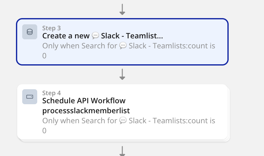

Step 2 could trigger sometimes, no?
I was troubleshooting an issue and I came across a workflow that has 2 steps that conditionally trigger based an item existing or not* and the first step creates the item. Does that mean that sometimes step 2 will trigger sometimes will not? Best is to put these in a fetch or create type of custom workflow, right?
* yes, I know, I’ll refactor the condition to :first item is empty
Can’t you use Result of Step 1 in this case?
Scheduling API workflows takes priority in workflows, so I suspect you may run into some timing issues here.
Unless I’m missing what you’re doing here.
You have to do Search:plus item Result of Step 1:count... to ensure it includes everything
Yep.
I would put these 2 steps in a custom event and pass the condition as an event parameter instead.
This way you are assured that the result of your condition stays true or false throughout the custom event.

If step1 doesn’t run, step2 will try to run without a record, which accomplishes the task of skipping the step.
I went with this; a bit of belt-and-suspenders approach.
Yep, this is normally how I do it. For this case, I will keep it like this for now.

The “mental model” that you should have is still that things run in sequence. Technically there are certain circumstances where consecutive “create a thing” or “make changes to a thing” actions can run in a single block, all at once
  • Bubble only does this if the actions change different things and don’t depend (in any of their properties) on the other changes in the batch
  • so you should not be able to notice when this does or doesn’t happen except that things will finish faster and you won’t (even if you watch closely) see a gap between the first change and the rest
  • if you get a different end result than if all the changes ran in sequence, that’s a bug that should be reported – but to my knowledge it’s not common. In your example, it’s not a bug, but a “miscommunication”; Bubble doesn’t know that Step 2 relies on Step 1. Technically it should “randomly” fail (since it’s a matter of database timing), but in reality I’d expect it to fail pretty consistently.
The underlying challenge is not really that things don’t run in sequence, but that 1) Database operations by nature have a delay, and 2) Bubble can’t always tell that two operations are connected. For example, if you Create a thing in Step 1, and then Search for things of the same data type in Step 2, the database may not have had time to update (and the search may be using a cached version to speed things up), and it’s not obvious that Step 2 needs the update to be finished. That’s why Result of step 2 is the safer choice — it tells Bubble that Step 2 relies on Step 1.
