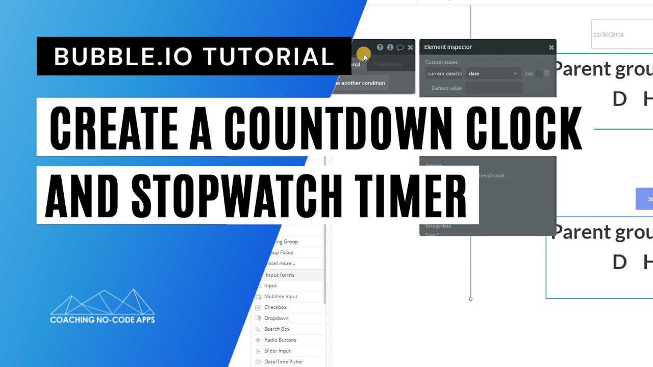

Currently I am using a timer on a page that is displayed to count how many seconds a machine has been down. The timer was built with this tutorial:
In essence, it uses the current date and time in the real world as well as the current date and time which starts when you click a start button (by set states elemental action).
