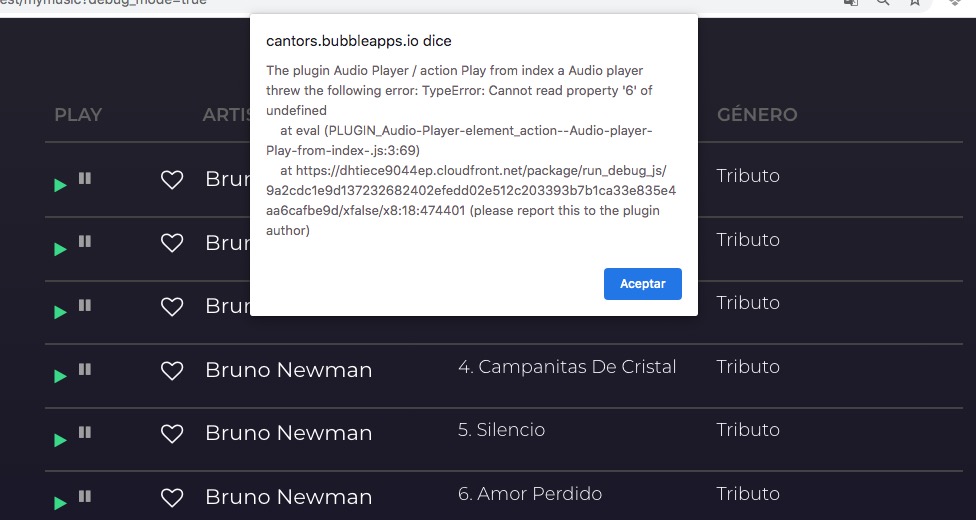

However i tried it in the streamy template and appeared this message:
after i close that window. if i click the play icon again, i can run any track from the playlist

Hi, @jeronimosada!
Could you please share the exact steps after which the issue is occurring like what you press on (the last song in the list or any song from the list). Also, make sure that in the database under the number “6” you have a song not the other file.

1 begin in the landing page
open any album
select to play, in this case the second track
appears the notification
i close the warning window, the player is now on, and loaded in the page
now i can play any song from this or any other album, as long as i dont refresh the browser

Hi, @jeronimosada!
Thanks for additional information. Unfortunately, this use case is not reproducing on our side. To figure out better and help you, could you please please, add our support@zeroqode.com account to your collaborator’s list in Settings -> Collaboration so we could check the issue inside your application. Plus, please tell us the name of your Bubble application and page name where you develop it, it would be way easier for us to help you solve the issues.

Hi, @jeronimosada!
Thank you for adding our e-mail to the collaboration list. So, after investigation, we have found that because of the multiple states the issue was occurring. Please, add a pause before the Play from Index AudioPlayer New in the workflow of the Play icon:
